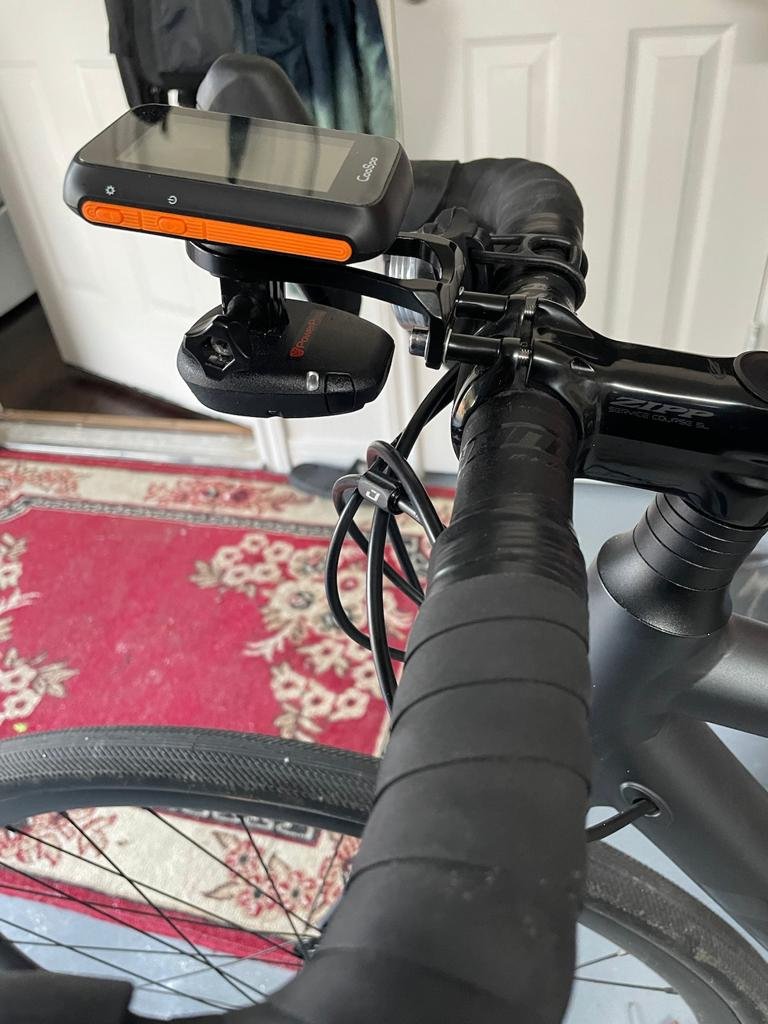

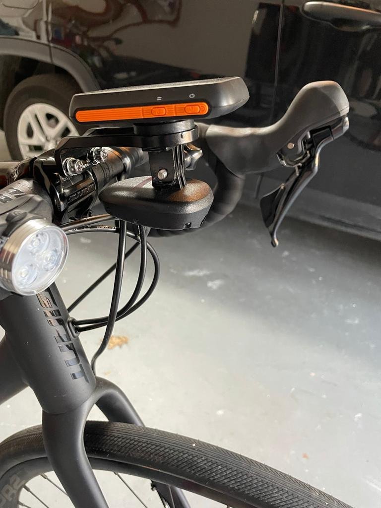

Attaching one of my ride data along with the pictures of how I have this mounted on my bike - to get your expert knowledge if everything is setup accurately.
Is my PowerMeter calibrated? Feels like too low power.

Your ride file shows you riding in very strong headwinds and tailwinds. In this situation it is difficult to tell if your V3 is properly calibrated, though I don't see any obvious problem in your profile settings.

Your PP is securely mounted to the bike, so I don't see anything obviously concerning...other than HR readings. In fact, where you work hardest in the ride, climbing a hill near mile 9, your HR goes DOWN! Something is not right...
