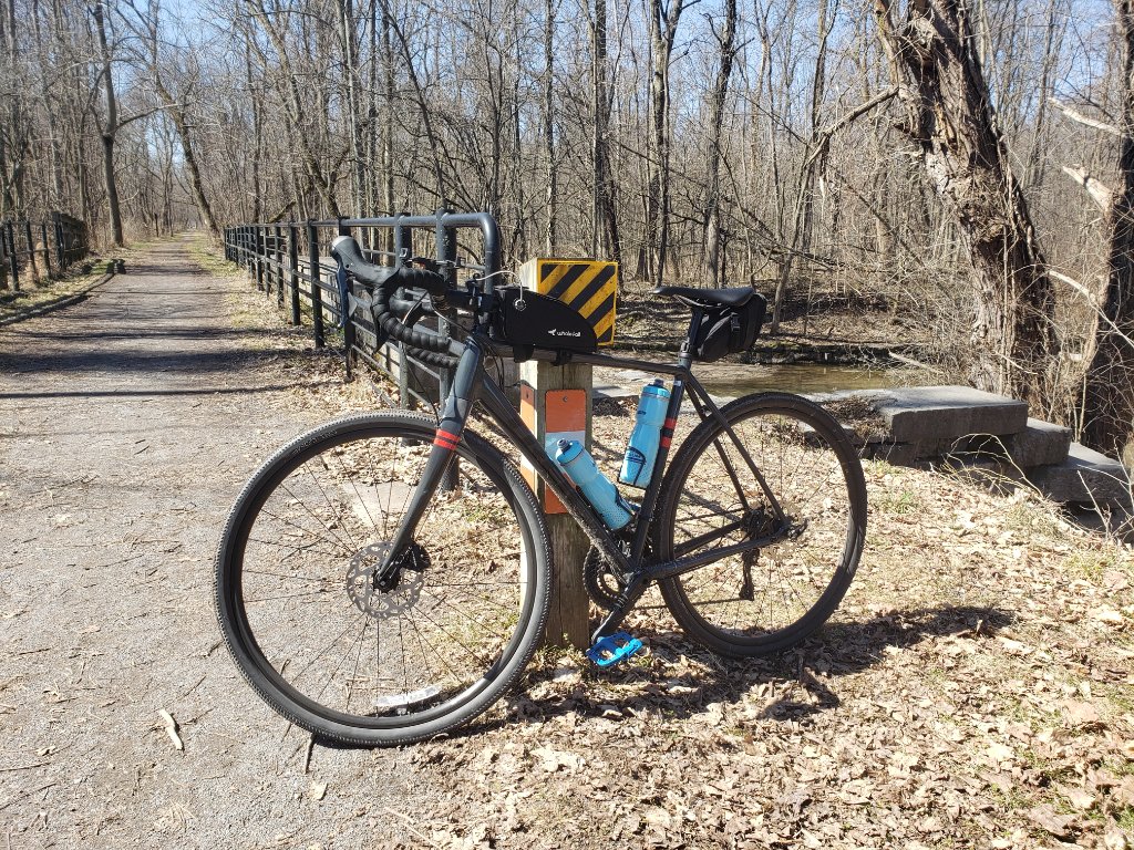

I just got my powerpod v4 yesterday I calibrated it this morning on this exact path if you watch it from the start https://www.youtube.com/watch?v=NuissplxtrU everything looks good but I wanted to double check. Here is a 5 mile ride on the same path from the powerpod after I calibrated. Does everything look good for the road type and bike I am using a check point ALR 5 gravel bike with 700x40c tires, power readings seemed close.

Your calibration is spot-on, but you have a very high Crr (rolling resistance). What kind of bike are you riding, and on what kind of roads?
You have PP set to Dynamic Power Smoothing. That is fine, but you can get faster response by setting it to shorter averaging.
Also, if your bike computer is averaging, that too will delay response time.

Hard pack gravel and dirt is where I ride its a 50 mile trail and I am using this bike at 35-40psi in the tires. I do use the bike on road sometimes too so I plan to have a sep calibration and profile for those rides.

Being I am a software test engineer for a living I took the liberty of doing some analysis and research. Seeing from other advice on the forums the only setting I should be playing with to get this accurate after a calibration is the CRR(I did this on the ride files using Analyze->tweak) , which from the auto cal and tire selection wanted 0.0136, this is actually very close to my real power curve when compared to historical zwift rides on a direct drive trainer. when I took a closer look 0.0140 crr appears to be the correct number(Within 3% margin) after doing a 15 mile ride and 2x 5 mile rides today on the path to get data to compare against. This path has less then 1% slope change for the whole duration so its pretty good to get a idea of rolling resistance.
So for all you gravel bike riders riding on hardpack dirt and gravel with 36c or wider tires at around 35-40psi 0.013 crr is a good starting point for that type of riding and for the road I found 0.0085-0.0095 seems to be fairly accurate when compared(Need to do more riding on paved surfaces to get data)
Please let me know if this info seems way off Velocomp so others don't follow it but I think I got it locked in now. I was sort of worried my CRR was so high from reading other stuff but it seems very accurate when I apply the CRR value to a ride I did post ride.

I set it manually after calibration, this is the process I used:
(Complete a regular auto calibration on the surface before starting)
1. took a ride with the auto calibration complete,
2. imported that into Isaac,
3. knowing my real power curve in the last 2 months I used that as a baseline to adjust the CRR on the auto calibrated ride until it matched my power efforts I expected for the ride
4. Set the CRR I found in step 3 and sent it to the device profile
5. Went on a hour ride at tempo with 4 targeted windows of effort 2x 1 min max effort and 2x 5 min max effort
6. Imported the hour ride into Isaac and strava
7. Compared the over all ride to what my appeared effort was but more importantly check my 1 and 5 min efforts to see how they matched up with a known power curve.
8. Validated my CRR from step 4 for that type of surface ride
Hope this help.

I did a hour long pavement ride today on this same bike to help get a baseline auto cal had it correct selected 0.00851 crr which matched up perfectly with my power curves for the efforts. These test were done with the Bontrager GR1 Team Issue Gravel Tire 700x40c inflated to recommended PSI 45-50.
