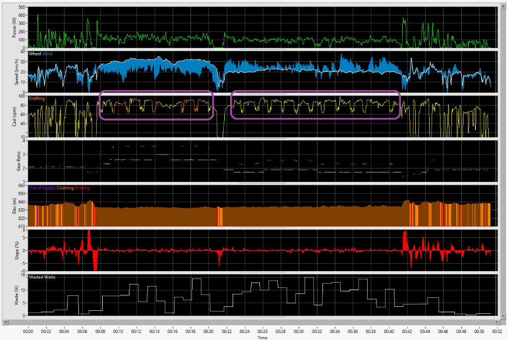

with a PP BLE I see strange intermittent drops in the Cadence values.
It shows on my Garmin Edge where I noticed it first, and it also shows when opening the ride with Isaac.
See the image where the marked purple areas show the drops very clearly:
I hardly changed gears, there was no need except for some wind fluctuations, so Gear Ratio looks funny too.
The areas relate to an asphalted, flat, long two-way cycling path which I rode two ways (O-B).

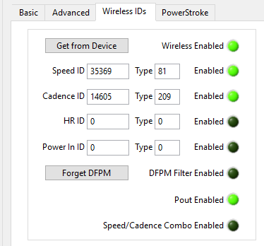

I have tried removing the sensor batteries for 15 minutes, and hard-resetting the PP (>10 sec press).

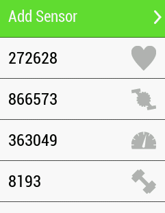

In my Edge I only see the PowerPod as Power meter (dumbbell symbol) Network Ant+, and the Garmin speed and cadence sensors.
And if there is some retransmission by the PP, I could see that this has an impact on the Edge, but why would the PP itself also show cadence drops?
Garmin Edge shows them like the attachment (HR strap, cadence, speed, PowerPod).

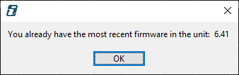

Thanks, but I guess that is for a different model. I seem to have the latest FW already for my PowerPod BLE:
[edit - add comment]
But yes, other devices which received FW 714 in November 2020 got this fix:
Fixed a bug that causes cadence measurements to be incorrect when used with certain cadence sensors, such as Garmin Cadence Sensor 2.
The 641 update is from 2018 so probably this fix did not get ported to my device. Yet, I hope.
Also, strangely, why would the Garmin Edge be impacted, as it connects to the sensor for cadence and not to the PP?
Re: Intermittent drops in cadence
This is a bug that is peculiar to the newer version of the Garmin cadence sensor.
We fixed the cadence bug for more recent versions of PowerPod (FW 7.16+), but did not release firmware with the cadence bug fix for older PowerPods using version FW 6.x.
I will see if we can address this problem, but no promises...
