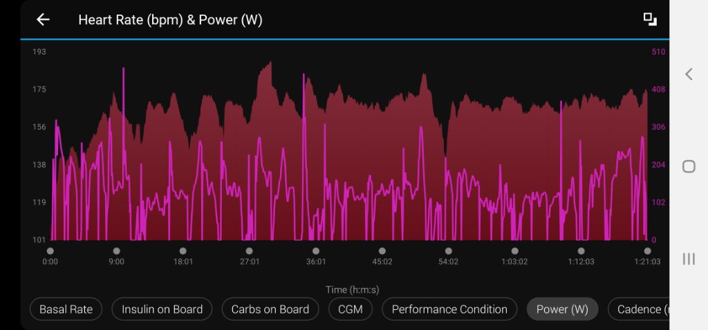

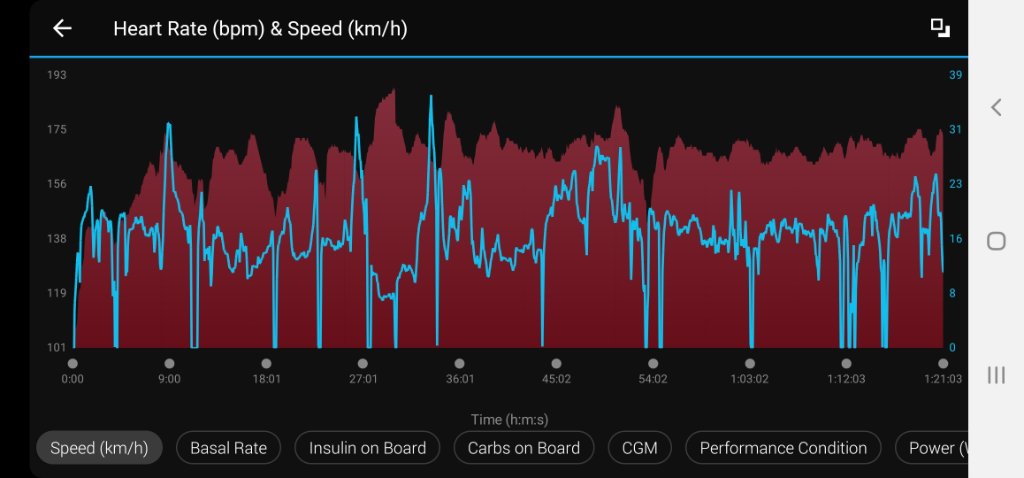

Re: Are my settings too low?
I'm afraid I don't have a Heart rate strap, but I'm tempted to get one.
I do track it with my garmin, however - not sure if that is of much use to you.....
I've attached HR and Speed (blue line) as well as HR and Power (pink line).
I may have to look at getting a chest strap to pair.
By rolling resistance is too high, do you mean 0.019 should be lower, say at 0.015 or something? Or.......
