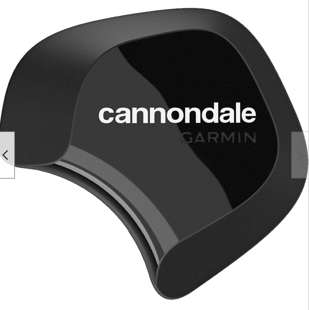

el sensor que lleva mi nueva bicicleta es
Sensores de rueda
Cannondale Wheel Sensor
Sensores de rueda
Re: Problema PP con Sensores
Does it look like this?
This sensor should work with PowerPod. I suggest you pair the sensor to your bike computer, then spin the wheel and confirm on your bike computer that the sensor is sending information. Assuming the sensor is functioning, try pairing it to your PP.
If sensor is functioning but PP pairing does not work then do a hard reset of your PP (press-hold the PP button for 12 seconds; it will start flashing green after a few seconds, but keep holding it until the light goes out briefly, then starts flashing again. Release the button).
After hard reset try a new sensor pairing.
