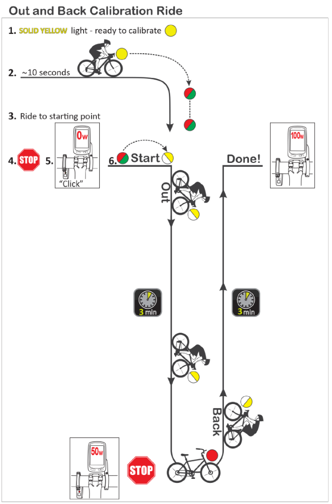

HA! I have already done a bike ride, begun celebrating July 4, and said "happy anniversary" to my beautiful wife Jo Anne (today is the day; she calls July 4 "Dependence Day")
Attached is a graphic for the shorter O&B ride.
We've basically gotten rid of the "Better Accuracy" calibration mode. Any time a cal ride is done, the unit will go to "Best Accuracy" (O&B) mode.
In general we discourage doing sensor pairings, except when required. The big danger is that, unless you're by yourself, you will pair to someone else's sensors! I agree that the pairing process now requires an O&B ride--a potential inconvenience--but the new process eliminates the need to connect to Isaac to initiate an O&B ride--a real benefit.
The reason we eliminated the cal ride recording is because it is the file AFTER the cal ride that reveals if everything "took" properly. You've probably noticed that, when forum members ask me to check things, I always ask for the ride file AFTER the cal ride.
With that, happy July 4 to you!

Helpful stuff, thanks. If you don't need to use Isaac to do O&B (great news) how does one get to the yellow light status to initiate an O&B ride? Hold the button for >5 seconds to initiate pairing, or is there some other sequence of steps to initiate an O&B calibration ride without re-pairing sensors currently paired?
Sorry for being dense on this
Re: New Firmware 640 for PowerPod
Wake up all your sensors, then press-hold PP button for 4 seconds, to initiate sensor pairing. Basically, you are doing a new pairing to your same sensors.
At the end of the sensor pairing the light will go solid green, then turn off.
Your PP is now ready for an O&B ride. When you click the button again the light will be solid yellow (ready for O&B ride).

Unless someone knows a workaround the new limitations on calibration, only using an out and back ride, make creating a calibration for use on a track bike impossible.
Calibrating on a track is easy. Ride "out". At the 50% mark, stop momentarily. Then, continue riding in the same direction until the ride is complete.
Because you're on a track, it already is its own "out and back" route!

My powerpod is December 2016, it is updated to version 6.41
What I want is to calibrate it in the best possible way for my mountain bike (cda, crr ...), I have a speed / cadence sensor installed and I have the powerpod on the handlebar. What would be the best calibration?
