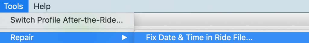

1. How would Isaac know the date/time is wrong, before the user says it is wrong?
2. It is not a simple thing to change the PH app to transmit date/time.
If the date/time in a ride file is wrong, you can use the command below to fix the date/time. (You don't have to have the exact date/time in the correction).
Then, re-sync your GPS data. It should work just fine.

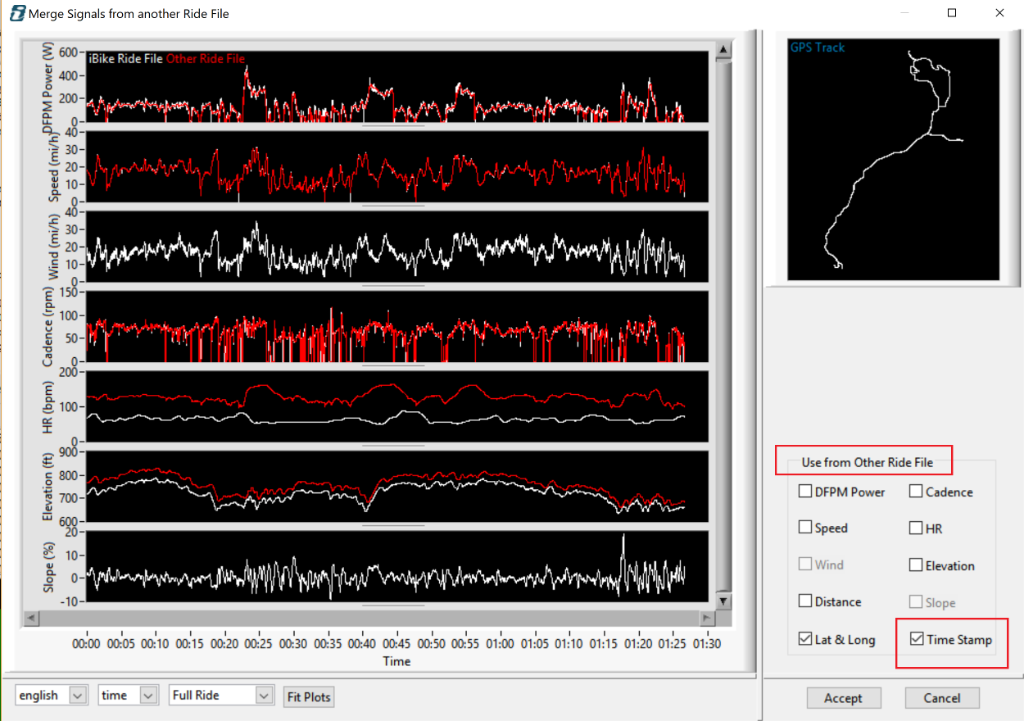

I understand that changing an app can be a complicated process but as it stands the lack of a user interface for the Aeropod is an obstacle that users have to work around, not what I would expect from a user-friendly product. The Powerhouse app comes as close to an interface as we are likely to see and its usefulness is decidedly lacking.
I'm quite familiar with the process you describe for changing the date/time, having been forced to use that function any number of times when Isaac arbitrarily changed the date/time of a ride file to match the date/time of a Newton Tracker file that Isaac "THOUGHT" was a good match. One of the many reasons I stopped using Tracker.
It seems to me that if Isaac offers to use the date/time from the GPS data that it should use it even if I have not gone through the process you outlined.
As best I can tell checking that box has zero effect:
- Useless Checkbox in Isaac.png (272.57 KiB) Viewed 5016 times

Personally, I've never used that checkbox. My process is:
1) I update the date/time of the ride file
2) I then merge with GPS data

Similarly I thought that you should be aware that the checkbox in the merge dialog is non-functional, whether or not you use it. SOMEBODY obviously thought that it was important enough to include that in Isaac ... they just didn't do a very good job of implementing it.
