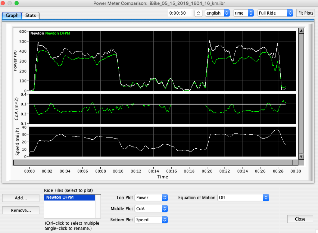

Hello,
I'm trying to make sense of the CdA measurements, is the Calbulated or DFPM power taken for calculations?
It's been windy today. On the first image CdA looks strange, nothing really changed on the second run, but the CdA is dropped to what I would expect to be normal range:

Re: Recalculate CdA from a recorded ride + DFPM
Actually, I think things are fine (though there may be a bug in Isaac).
1. It looks like you're not on profile 4; I say this because it looks like your HR data is being shown, not your CdA data
2. There is a separate window called "Tools/Power Meter Comparison" which also calculates CdA. This window shows that your "out" CdA and "back" CdA are about the same.
Power Meter Comparison with CdA = 0.296
Screen Shot 2019-05-15 at 6.25.25 PM.png (136.63 KiB) Viewed 8757 times

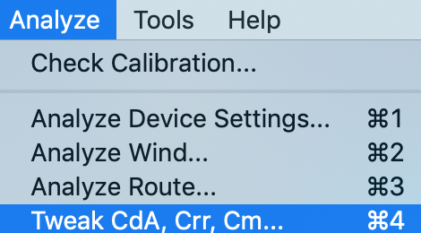

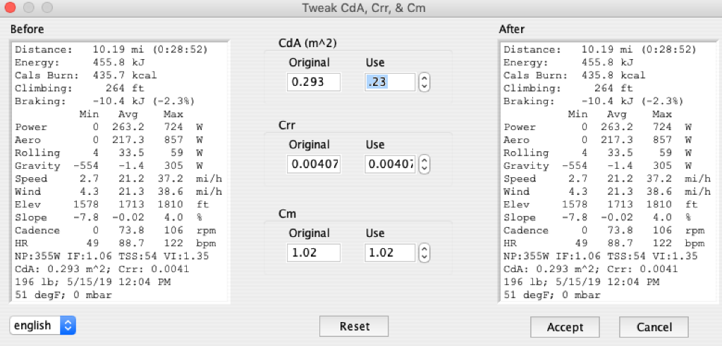

It looked to me that your CdA was about 0.23, and when I used that number in the "Analyze/Tweak CdA..." screen
Analyze CdA command
Analyze CdA command
Screen Shot 2019-05-15 at 6.27.33 PM.png (177.19 KiB) Viewed 8757 times
Change CdA to 0.23
Change CdA to 0.23
Screen Shot 2019-05-15 at 6.28.08 PM.png (151.62 KiB) Viewed 8757 times

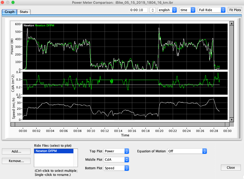

I got great results!
Power Meter Comparison with CdA = 0.23
Screen Shot 2019-05-15 at 6.28.46 PM.png (140.84 KiB) Viewed 8757 times

Thank you for a quick reply!
0.23 is what i'd expect, thanks!
