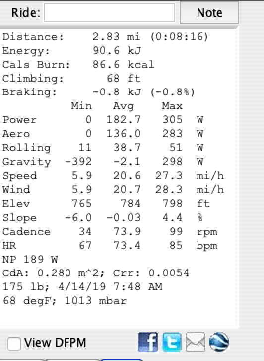

There is a different way to look at CdA data in Isaac, that avoids some of the algorithm pitfalls of Isaac Analyze CdA window. Here is what to do:
1) open the ride file you want to look at. In this example, I'll use your "5784" ride file.
2) The CdA measured by AP/HR is 73.4 * 4 / 1000 = 0.293 The "baseline" CdA was 0.280, somewhat lower.
3) In the stats window toggle between View DFPM checked, and unchecked. With CdA set at 0.28, AP watts are lower than DFPM watts.
3) Since AP watts are low with CdA = .280, this means the actual CdA during the test was higher than 0.280. Let's see how close the AP measurement of 0.293 is...
4) Use the Isaac command Analyze/Tweak CdA...you will see this window:
5) Now, change CdA to 0.293 and click Accept. Note that AP watts rise to 189.6
6) This is still 2W low; if you change CdA to 0.296, you get total agreement. (Note that the .003 difference is within the round off error of HR)
What the above means is:
1) HR/CdA data from AP is correct
2) Isaac CdA Analysis is not as good as actual data (no surprise there)
3) You can check HR/CdA data with the Tweak CdA command
There are issues with Isaac CdA Analysis recalculations, but in our view, AP data is good.
