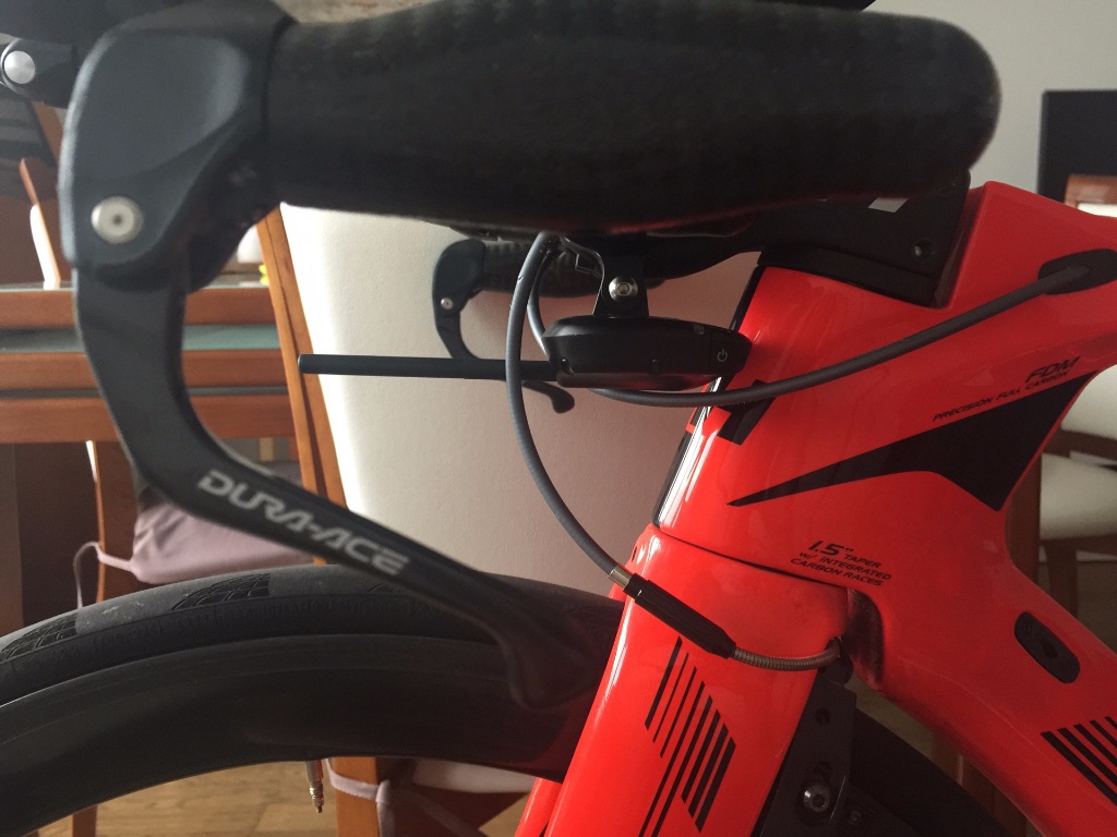

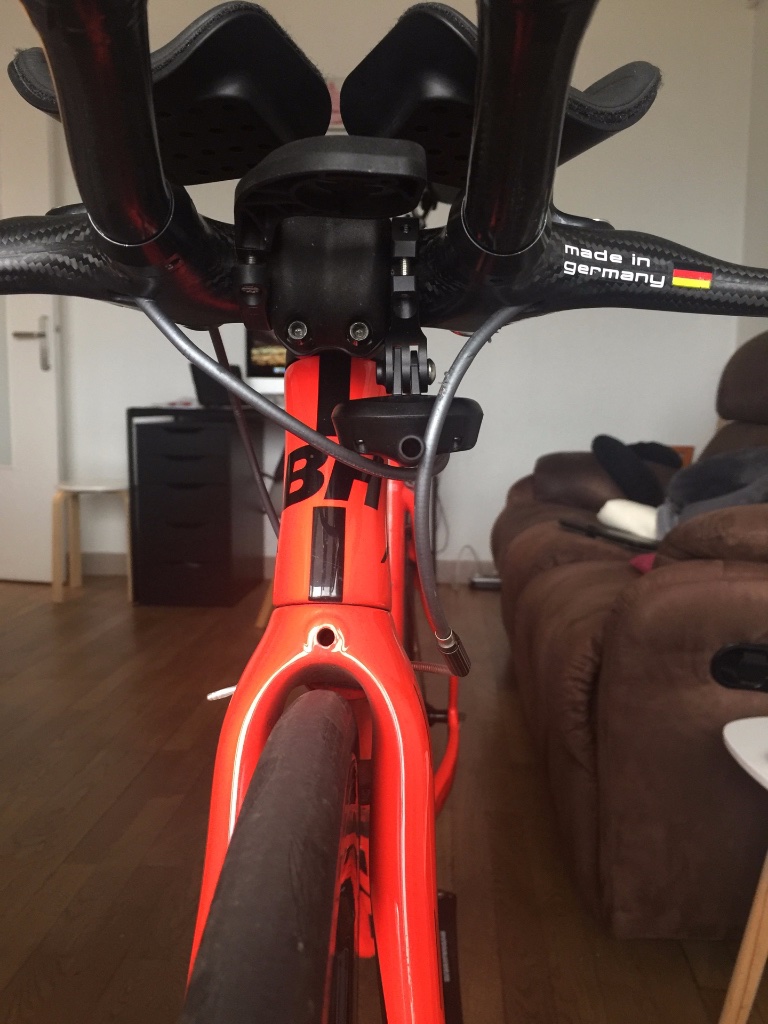

Please send images showing your front fork, and showing how AP is attached to your bike.
agud
Posts: 17
Joined: Tue Aug 20, 2019 3:07 am
Re: Use Aeropod without isaac
Post by agud »
my aeropod fixation
Image 2.jpeg (189.19 KiB) Viewed 21934 times
agud
Posts: 17
Post by agud »
Your cables are touching AeroPod. I think this may be causing unstable readings.
Please move your AeroPod, or your cables so that they do not touch AP.
Yes, the location of your cables could be a real problem. It looks like one of your cables passes directly next to the baro port hole.
