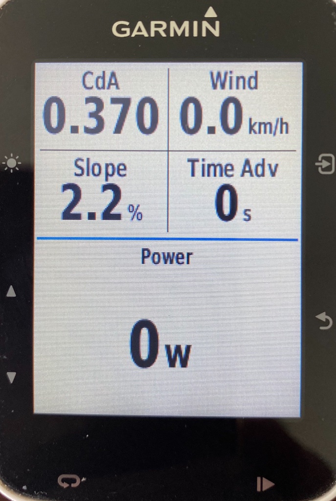

Notice anything different?
This is thanks to our AeroPod user Oleksiy. The new ConnectIQ app with metric units option should be released in a few days.

An observation for those owning PowerPods, not AeroPods - and others may not agreee, for sure:
If this had been designed a little differently - one line having wind and slope, the other with Cda and time advantage - and as two separate setups not a 2 by 2 - but 2 separate 1 by 2 boxes - those with PowerPods would not have to see the other two useless parameters (for PP users).
Don't get me wrong, I am still thankful that the two useful data fields were made available long before Garmin puts some standard out that allows everyone to just design their own screen. Sometimes a bit more thought in how something will be displayed does have its purpose.
Wind | Slope
Cda | Time advantage
I am not asking anything to be done with the current situation - But If Oleskiy would like to crank another option -- so much the better and no expectations until Garmin does what they should have done some time ago.
