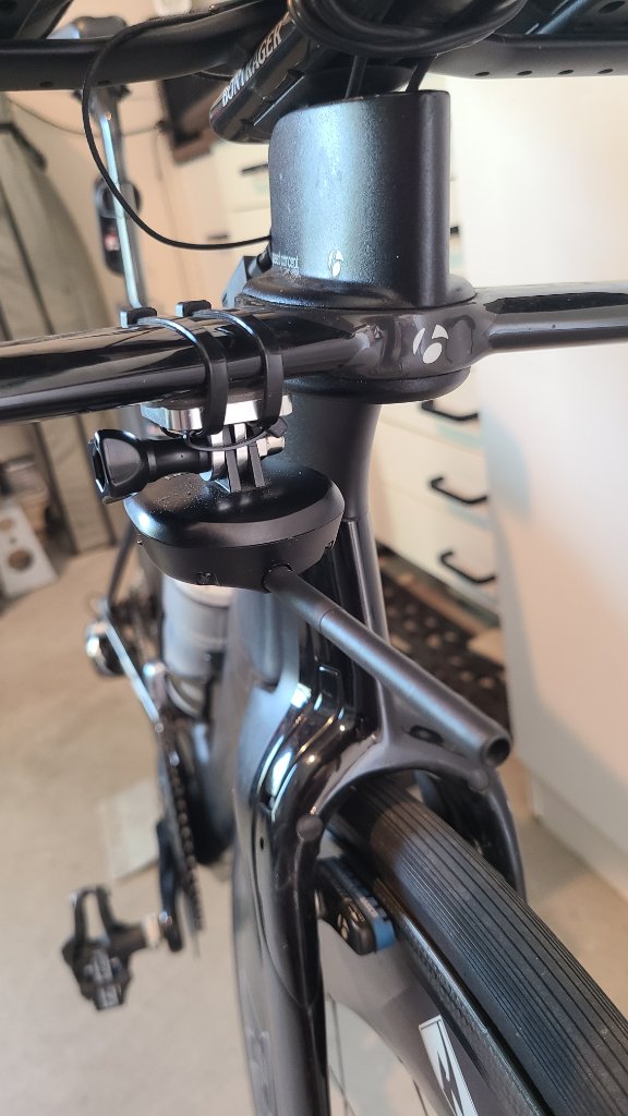

I have attached two photos of how i attach my aeropod to the bike. Is there a better way to attach it to my Speed concept?

- aeropod-mount.jpg (104.92 KiB) Viewed 17734 times
- aeropod-mount2.jpg (128.61 KiB) Viewed 17734 times
Re: Aeropod high accuracy test for 40k TT real world validation peer check
The problem is your mount. There is no way Zip ties are going to keep your mount stiffly attached to the handlebars.
