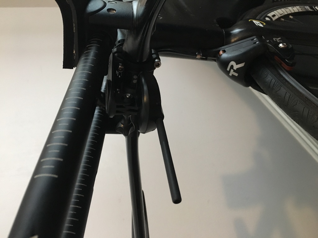

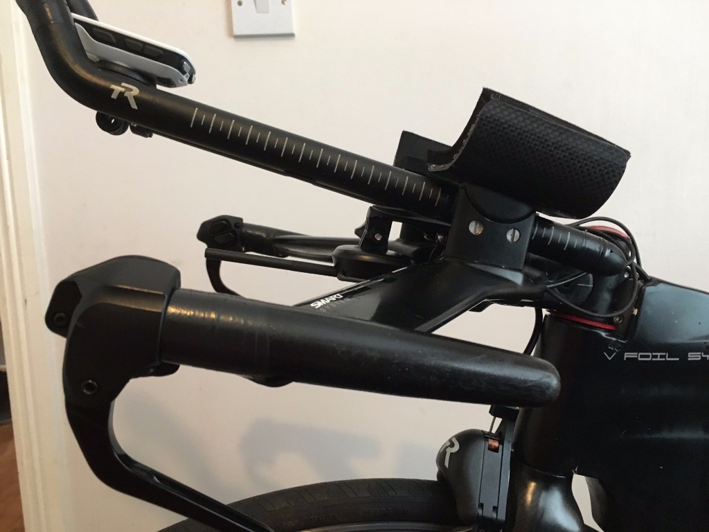

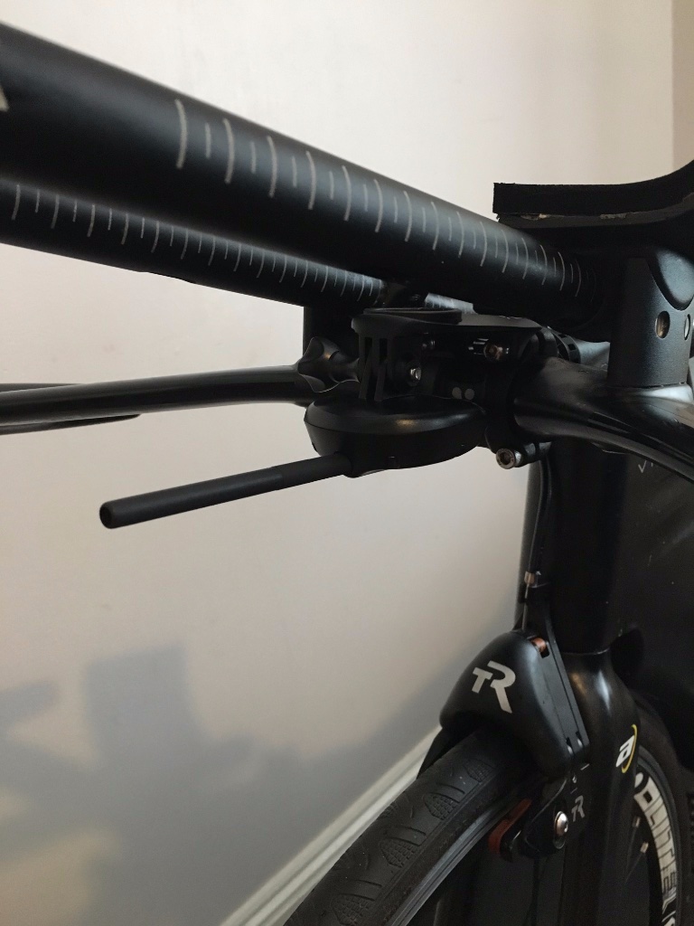

So I take it the Velocomp combo mount is not suitable? That is what I planned to use, as shown in the photo below:
So first question is, are you saying that mounting on the extensions will not work due to vibration? This would seem to be a very good place to get clean air, as the pitot tube is the leading edge on my bike as pictured. I run TriRig Alpha X bars, there are no extra bolt holes for an alternative mount configuration. Not sure what to do here.
You can also see that the pitot tube is not horizontal. That seems to be due to the decision to adopt a GoPro mount interface I have never seen before. One side is rounded and one side is squared off. I have been through a ton of GoPro mounts over the past 8 years, have a large bin full of all different types, and have never seen this squared off variation. Is there a reason for this? It limits the ability to rotate the Aeropod into a horizontal position.
Re: TT bike mounting
This will not work.
1) Aerobars flex; this causes severe problems with CdA measurements.
2) You AP is pointed too high. This too will cause problems.
The flat surface on the AP allows AP to be mounted at a consistent angle. It is intentional that AP has limited rotational capability.
I think you have been in email correspondence with Tom, who has an alternative approach that should work underneath your handlebars.

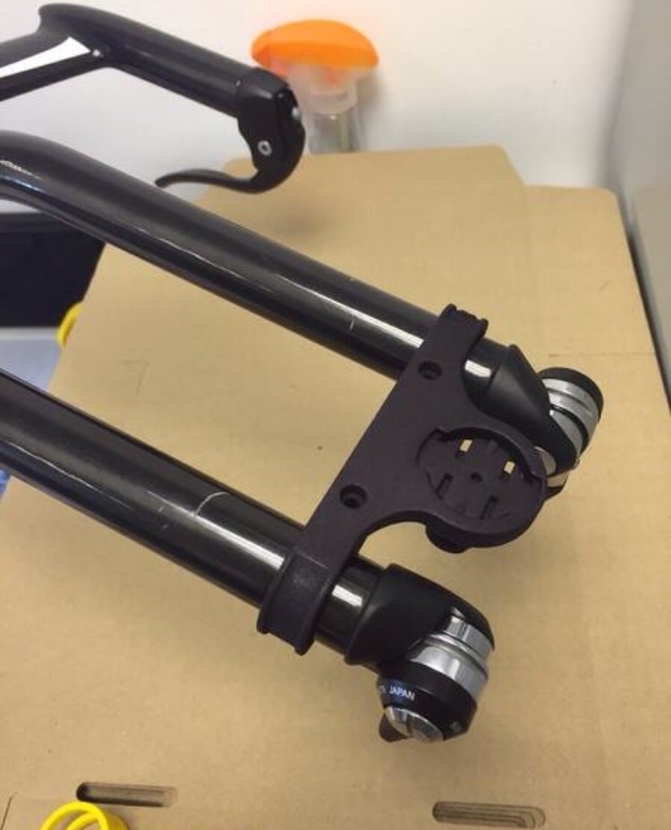

Is there a mounting option for bars like this, which don't use bolts in the base bar? This seems to be the direction more and more aero bars are going.
Yes, our under-the-bars TT mount. It looks like you have just ordered one!

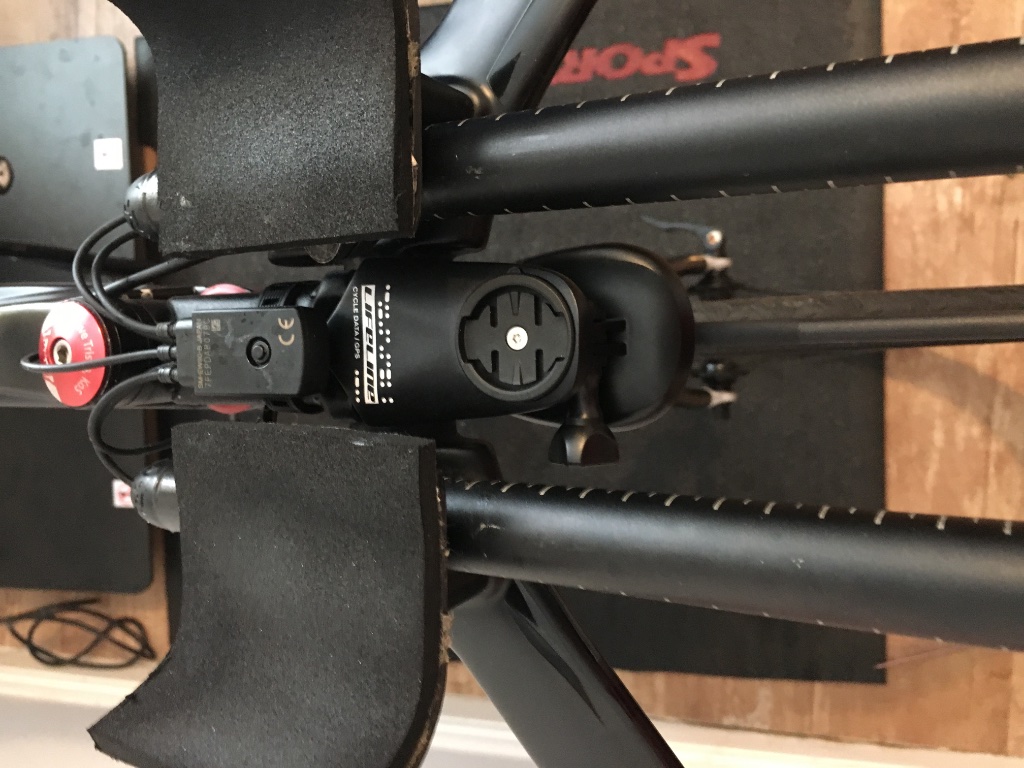

I've had success with a Lifeline stem mount. Quite solid and inflexible.
- IMG_3052.JPG (182.26 KiB) Viewed 30247 times
- IMG_3051.JPG (161.56 KiB) Viewed 30247 times
- IMG_3054.JPG (232.93 KiB) Viewed 30254 times
- IMG_3052.JPG (180.95 KiB) Viewed 30254 times
- IMG_3051.JPG (160.67 KiB) Viewed 30255 times
