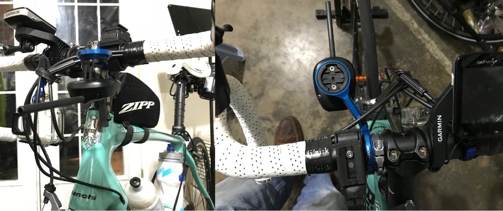

2) How is your AP attached to your bike? Please post images

I used the supplied mount on my TT bike and a K-Edge mount for the road bike. I wanted to make sure the Aeropod was well away from the lights and camera on the road bike. I'm afraid my experiments with the TT bike have not been interpretable due to other issues (mostly operator error)

I think there are several things going on:
1) You are on a loop that appears to be .22 miles in circumference (in the instructions we recommend a loop of at least 1 mile in circumference).
2) The straight sections of the track, where CdA data will be most stable, appears to be only .06 miles long (each side). This is way too short for data gathering
3) Though the track is flat (a good thing!) the curves are not helpful to CdA analysis. Essentially, in the curves the bike is angled, which can affect CdA measurement
4) The slower the bike speed, the less accurate the CdA data will be. About ½ of each of your tests are at speeds below 15 mph. It may be that the small size of the track is limiting your bike speed.
5) In this ride file you do not have a separate cadence sensor, yet your cadence recorded is zero. We have not seen data from C1 before; it is possible something is different about the C1 data packet...we will have to look in to this.
6) Whether or not HR is paired to AeroPod, the CdA values it transmits to Garmin are unchanged.
I think you will get better results if you can find a different place for your testing, and if you do your testing at higher speeds.
