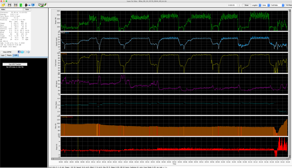

You're riding on a track, so average slope should always be zero. However, there is a drift in slope values; it is easy to see in the ride file in the slope graph at the bottom
Screen Shot 2019-08-25 at 9.49.23 AM.png (180.89 KiB) Viewed 3328 times
Slope change could be a result of sensor drift, or it could also be caused by changes in bike flex. We have been testing a firmware update to address this phenomenon, which hopefully we will release soon.

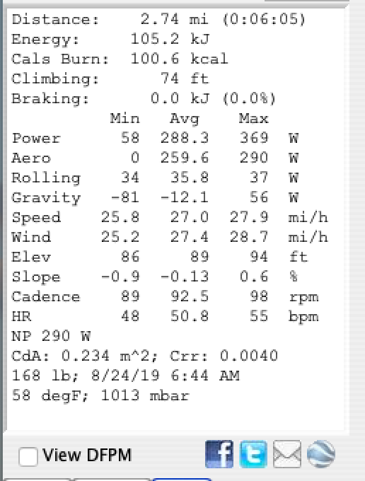

2) I open each file (for example, Test 1). Since you are in a closed loop, average wind speed should be the same as average bike speed, and average slope should be zero. I observe that wind speed (27.4) is a bit higher than bike speed (27.0), and average slope is -0.13%.
Screen Shot 2019-08-25 at 10.09.36 AM.png (60.66 KiB) Viewed 3328 times
So, Test 1 definitely needs some tweaking!
3) To correct the slope and wind errors I use the “Analyze/Analyze Route” command, which corrects for slope drift and non-zero net wind speed. After analysis the average wind speed is 27.0 and the average slope is 0.00%. So, we now have a good set of test data.

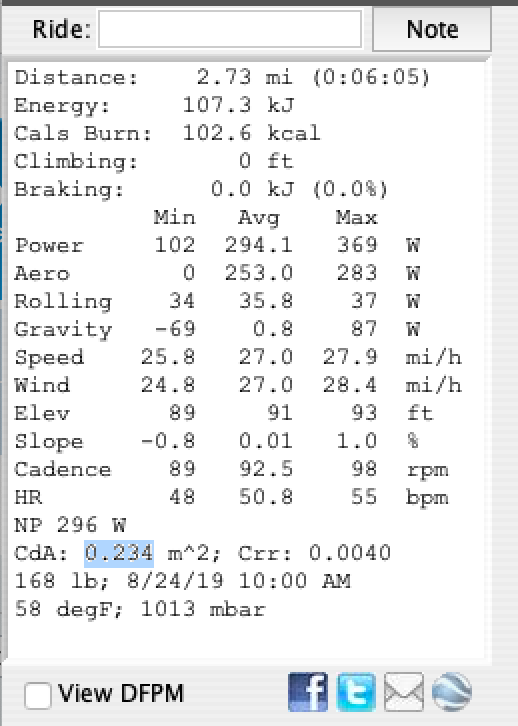

4) To obtain the actual CdA from the test (and this is where it gets a bit tedious, sorry), I notice that your average AP watts (293.3) are too high compared to average DFPM watts (258.6); this means that CdA has to be reduced from the assumed default value of 0.234.
Screen Shot 2019-08-25 at 9.55.23 AM.png (59.68 KiB) Viewed 3328 times

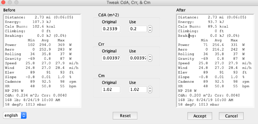

I use the command "Analyze/Tweak CdA", and then I GUESS a lower value of CdA. Lower CdA will reduce AP watts. My first guess of 0.200 lowers AP watts to 256.8—two watts too low.
Screen Shot 2019-08-25 at 9.57.28 AM.png (129.18 KiB) Viewed 3328 times
My second guess is 0.202—high by about 0.2W.
Screen Shot 2019-08-25 at 9.58.11 AM.png (145.89 KiB) Viewed 3328 times
I go to 0.201, now about 1W low.
Screen Shot 2019-08-25 at 9.58.55 AM.png (145.25 KiB) Viewed 3328 times
So, interpolating between the two, the CdA for Test 1 is 0.2019 . I save this file as “Test 1_Corr”
