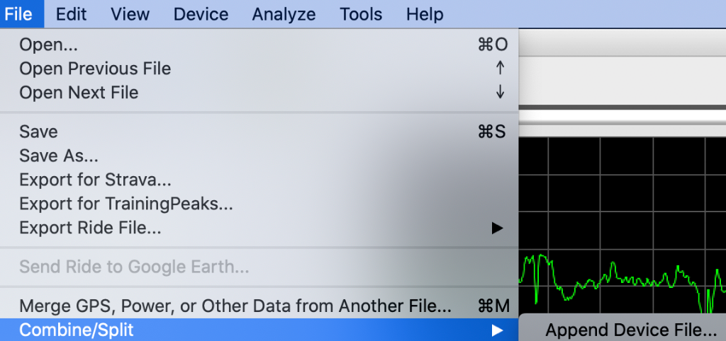

1) Use this command to append the later ride file to the earlier:

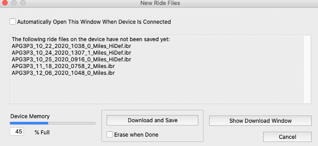

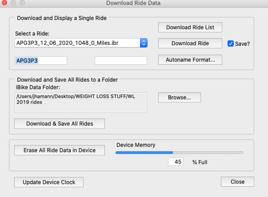

4) When downloading a ride, click the "Show Download Window" button. In the next window you can customize the name of your downloaded ride. In this example the ride file is named "APG3P3".
Screen Shot 2020-12-08 at 11.25.12 AM.png (194.47 KiB) Viewed 7221 times
