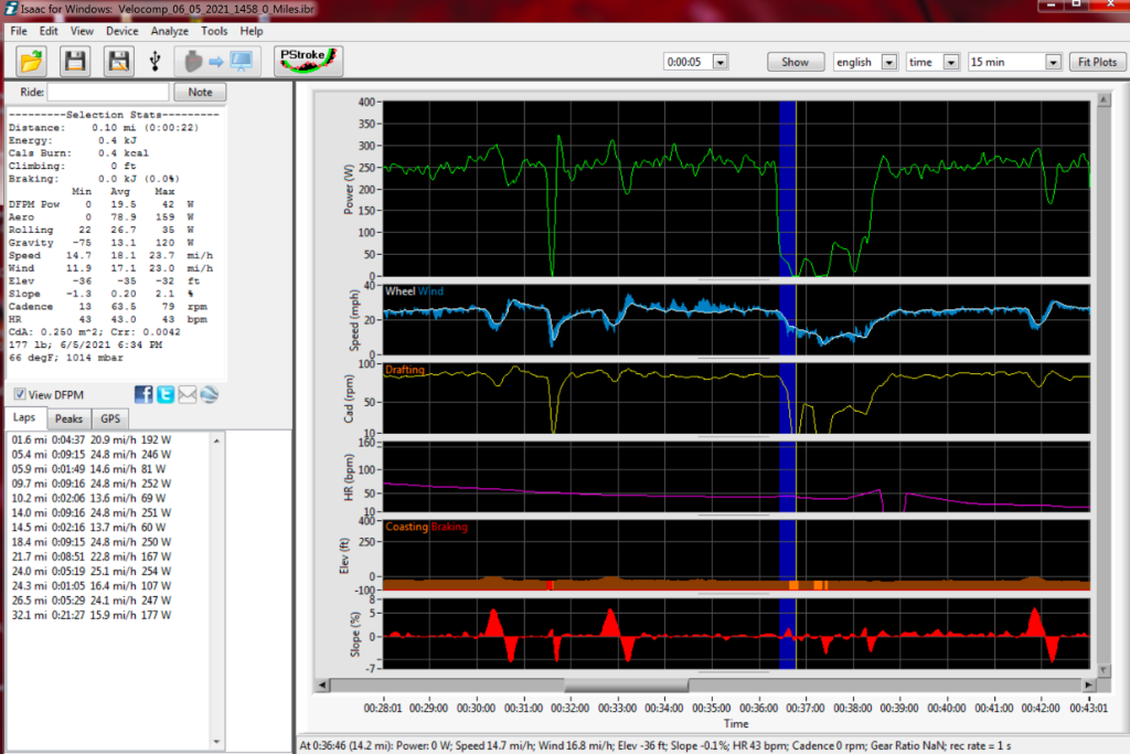

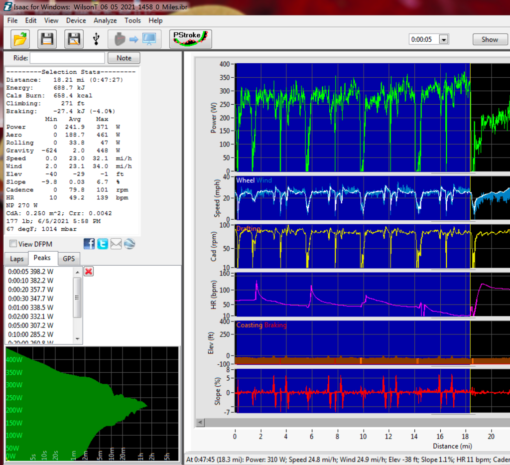

After a long hiatus, I finally took the time to try out the latest firmware with the updated profile 4 specific to testing. To test for consistency, I ran 4 consecutive tests using identical setups, same position, down to my head position. The day wasn't entirely ideal, as I had some amounts of crosswind, but the conditions stayed relatively steady during my test runs (the first 4 9ish minute laps I did were the test runs - an out-and-back course that was dead straight with a highway overpass.
On the first 3 runs, everything looked good and consistent, with the CdA started off relatively high as soon as I hit the lap button, and gradually dropping to what would appear to be my final CdA of ~0.222 to 0.225. However, on my 4th run, as soon as I hit the lap button, it gave me a much lower CdA value, around 0.190, and stayed low for the duration of the test run. However, as soon as I hit the lap button to complete the test run, the displayed CdA ended up showing a number that closely matched the test, at around 0.222. Could you explain what might have occurred here?
I've attached my ibr file to look over!
As an aside, I also did a couple of test runs (the last two 5-ish minute runs) wherein it was a different stretch of road - I know it's been said that the lap button must be clicked at the exact same spot, but is there any harm in doing a test run in one location (lap button at one given location), and then doing a couple test runs in a different location, with it's own lap button spot?)

On lap 4 there was a big change in your tilt calibration. Why this happened I do not know, but it is the cause of your low CdA registered during lap 4. At the end of the lap the "error" was detected and corrected, and your on-screen CdA was corrected to 0.222--very close to your other laps.
Lap 1 .225
Lap 2 .221
Lap 3 .223
Lap 4 .222
These are very consistent results!
Isaac does not have access to the on-screen correction factors used in AP firmware, so when you use Isaac "CdA analysis" feature it shows a low CdA for lap 4.
In profile 4, whenever you click the lap button, AP assumes you are in exactly the same physical position as where you last clicked the lap button. It's OK to move to a different location to do testing, but you need to do a warmup lap in that new location, with lap markers, so that AP can readjust its internal settings to the new location.

Thanks for the reply! That's awesome to know that the device corrects itself! I'm honestly not sure what might have been the cause of the tilt shift, as the aeropod still seems to be in the same position as I had set it in (I tightened the gopro clamp bolt really nice and tight).
After the lap 4 device correction, had I continued doing laps in that spot, would the CdA display have corrected itself, or would it still show the incorrect CdA numbers until the end of the lap? (I probably should've checked this myself but I was running out of time)

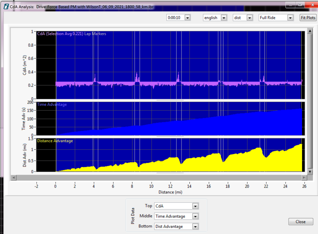

In profile 4 you get the most accurate CdA measurements. At the end of each lap the average CdA for the just-completed lap appears in the HR channel for the next 10 seconds of the just-completed lap (a flat line of HR).
In profile 4 only, CdA = (HR +180)/1000.
After lap 3, for the next 10 seconds after lap 3 your HR was 43. So, CdA for lap 3 = 0.223

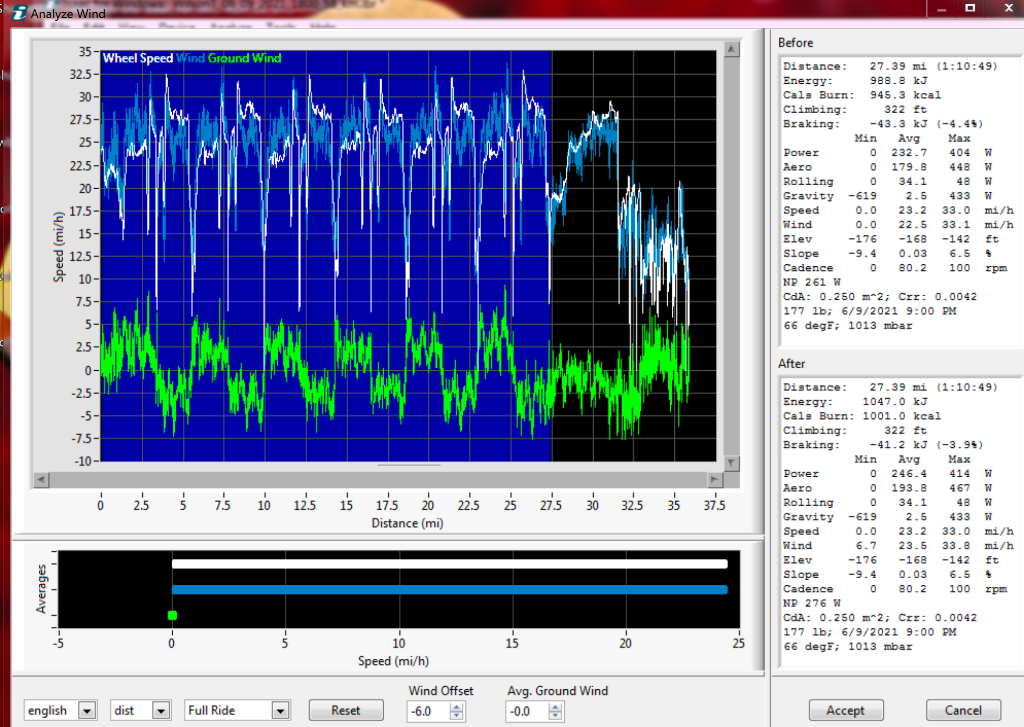

I did another day of testing, and I started off with another calibration ride (I tried to use the "Check Calibration" feature in isaac to export a corrected profile to profile 4, but perhaps it wasn't happy with that). In any case, after doing the calibration ride, all looked good and well, but when I started doing my baseline tests (same position as my previous file), I was getting wildly different numbers - instead of 0.222ish, it was 0.190. During a couple of my test runs, I saw numbers even drop below 0.08! Could you explain what I did wrong?
I've attached my calibration files as well as the ride file

If you look at your two ride files, you'll see that the wind calibration is different from each. On your 6/9 ride you have a net headwind of 1.6mph during your tests (on closed loops it should be zero).
On your 6/5 ride you have a net headwind of 0.1mph (this is an excellent calibration)
When the calibration is "hot" (headwind) then AP watts will be high, forcing CdA down.
On your 6/9 ride, I used the Analyze/Analyze Wind... command to set average wind to 0
After doing this, to see the approximate effect on CdA, I used the Tools/CdA Analysis to check how the reduced watts affected CdA. CdA increases to 0.221, essentially the identical result from your prior test
So, the answer is this: if you have a good calibration, don't change it unless there is a good reason!
CdA measurement is very sensitive to small differences in calibration.
