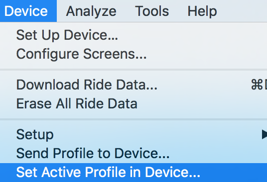

1) Attach your PowerPod to Isaac software
2) Go to "Device/Set Active Profile in Device..."
Screen Shot 2017-04-01 at 7.36.49 AM.png (94.69 KiB) Viewed 4182 times

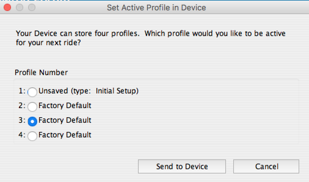

3) A popup window will appear, showing you which profile is currently active (in this example, Profile 1)
Screen Shot 2017-04-01 at 7.32.12 AM.png (46.17 KiB) Viewed 4182 times
4) Click the Radio Button to the left of the profile you want to be active (in this example, Profile 3)
Screen Shot 2017-04-01 at 7.33.02 AM.png (54.23 KiB) Viewed 4182 times
5) Click the "Send to Device" button
Screen Shot 2017-04-01 at 7.33.45 AM.png (12.4 KiB) Viewed 4182 times
The profile you have selected will now be active in your PowerPod
