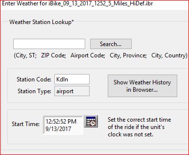

I am trying to correct the elevation settings in my powerpod. I have tried to use Isaac ->tools>repair> set atmospheric pressure but it will not accept my personal wunderground station. Airports are much lower than me but it doesn't seem to use those accurately. The simplest would be to enter my stating elevation into isaac and let it do the adjustment like my edge 800 does. Anyway how can I adjust my elevation.
Thanks in advance
Can't figure out how to use this
Peak should be 450 ft
