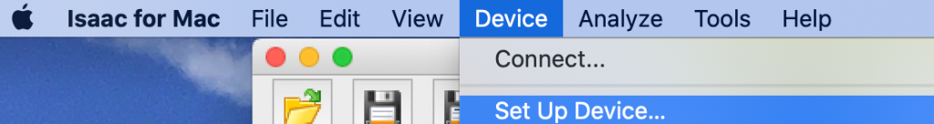

any way to change/update the surface for a ride? Profile is set to smooth asphalt, but want to change to gravel for a ride.
Marc
Posts: 7963
Re: change surface for ride
mxfarm wrote: Tue Mar 09, 2021 6:07 pm any way to change/update the surface for a ride? Profile is set to smooth asphalt, but want to change to gravel for a ride.
Marc
Yes, use the Device/Setup Device wizard in Isaac to do this

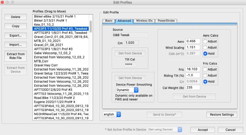

Yes, you can do this. Open your profile in Edit/Edit Profiles. Click on the Advanced Tab
Screen Shot 2021-03-11 at 2.54.15 PM.png (283.17 KiB) Viewed 3597 times
Click the radio button next to "Riding Tilt" to change it from Adjust to Hold
Screen Shot 2021-03-11 at 2.54.28 PM.png (301.09 KiB) Viewed 3597 times
Type in the Crr you want to use. Click "Send to Device" to update your PP. Rename the profile so you'll know it was for your gravel bike, then save the profile.
