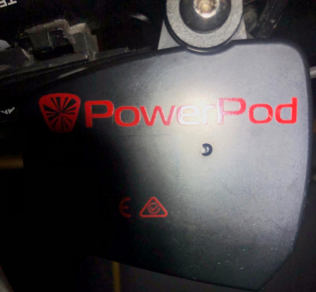

It looks to be clear - you can see something white behind a tiny faring.
I've tried to take a photo but it's not easy without a macro camera. Can you tell?

Re: Elevation Errors?
Good photo! Your baro port looks clear...

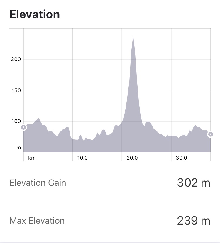

Had a short ride this morning after a full reset.
Unfortunately it looks to still be the same.
I’ve included a screen shot of the profile from my Garmin as a comparison.
email technicalsupport@velocomp.com for next steps. Looks like your elevation sensor is misbehaving...bluebarchetta wrote: ↑Sun Jul 21, 2019 2:38 am Had a short ride this morning after a full reset.
