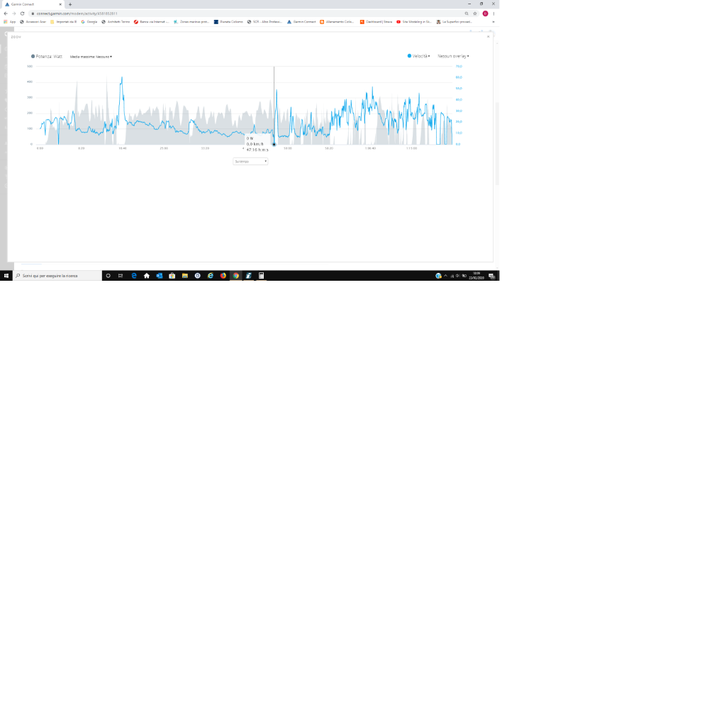

Hello John,
I reactivate this post because I have again noticed the problem of the difference in length of the paths. I attach the file of today's race. Compared to what calculated by strava and garmin connect (and by the garmin device itself) the total length would be 24.85 km, while isaac gives me 22.70 km. The time is substantially identical and the speed has never been so low as to justify stops of the PP, even if I continued to use the sensor on the hub. On the contrary, I noticed that the stops don't appear on the isaac file. I made a short stop around minute 47, as you can see from the attached image file, correctly recorded by the garmin but invisible on the .ibr. file, plus a couple of semaphores (not even these detected). Could this be a problem with the garmin or pp settings? or profile? I noticed that, sometimes, garmin and pp find it difficult to share the cardio sensor (not in this ride, however). the problem of the wrong distance does not always occur, for example in the two rides of the last weekend the distances corresponded. It's not a serious problem, but I'd like to solve it, if possible.
Thanks, see you soon.

Re: Inconsistent distance measurement between PP and Garmin
The Garmin, with its built in GPS can estimate your tire size (circumference) - What are you using for the tire size?
If you allow the Garmin to do the measuring and then add that to your PP/ISAAC profile, the two should agree pretty well.
Set up the Garmin, go for a ride at least until the Garmin will report that tire circus has been estimated -
The garmin should have already set itself this way automatically (it's a fairly recent hub sensor); on the powerpod I inserted the circumference from the table. I can try to acquire the measurement from the PP by updating the profile, as you say. Although the problem seems to me to be different; sometimes the distances match and other times not and stops are not recorded..(like yesterday). Anyway I will definitely try to update the profile, let's see if it works.
Thanks bye
Thanks bye
Hi, I tried to update the profile so that pp read the wheel size from the garmin but I was not successful. Can you explain the process please? maybe I did something wrong. The measurement of the distances traveled still does not match. The circumference measured automatically by the garmin is slightly lower (2299 mm against 2326 mm), so I don't understand why the total measured by the pp is lower ...
Thanks bye
Thanks bye
I'll take a stab. I've had to do that in mine, since the Garmin auto-tweaks the wheel sensor against the GPS Data giving what I think is a more accurate circumference. (I really should properly measure one of these days)Hi, I tried to update the profile so that pp read the wheel size from the garmin but I was not successful. Can you explain the process please?
In Isaac, when you edit that profile -
- Where it says "Tire Sidewall Marking", change the param to "Measured"
- Set the circumference match what the Garmin has calculated (presumably correctly).
- After updating, then send to device.
