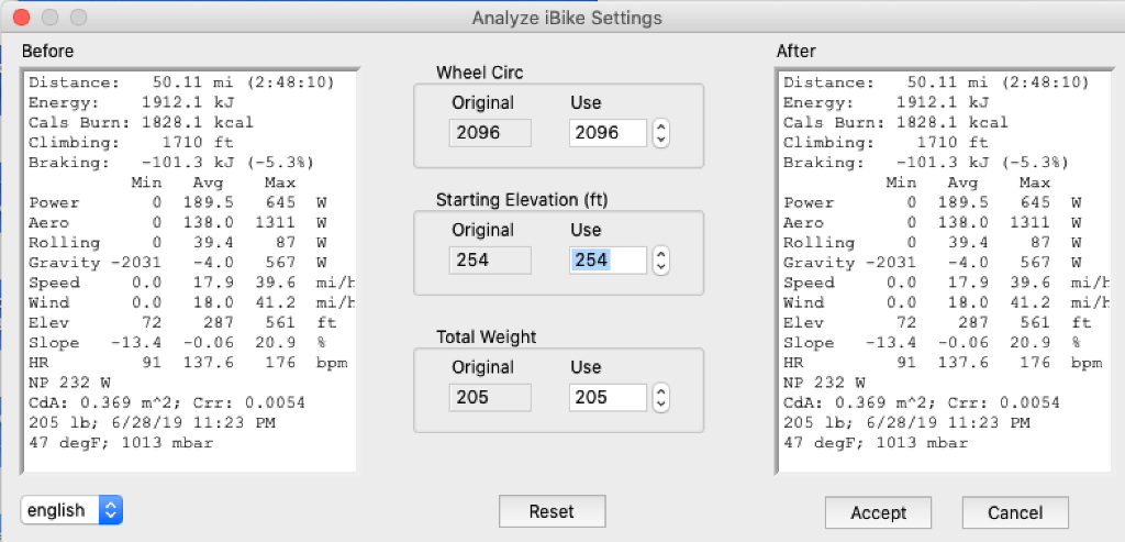

I know my home/start point is exactly 1100meter above sea level. The powerpod shows 1070. Does the 30 meters difference matter? And is that a way i can calibrate/set the device so it'd show 1100m exactly?
Thank you in advance
Posts: 7995
Re: Can i calibrate the elevation on the power pod?

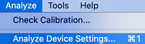

The only place you "see" PP elevation is in Isaac. After downloading the ride you can adjust the elevation with the commands below
Absolute elevation has no effect on power readings.
Screen Shot 2020-05-02 at 11.06.34 PM.png (124.82 KiB) Viewed 2742 times
Screen Shot 2020-05-02 at 11.06.18 PM.png (100.02 KiB) Viewed 2742 times
