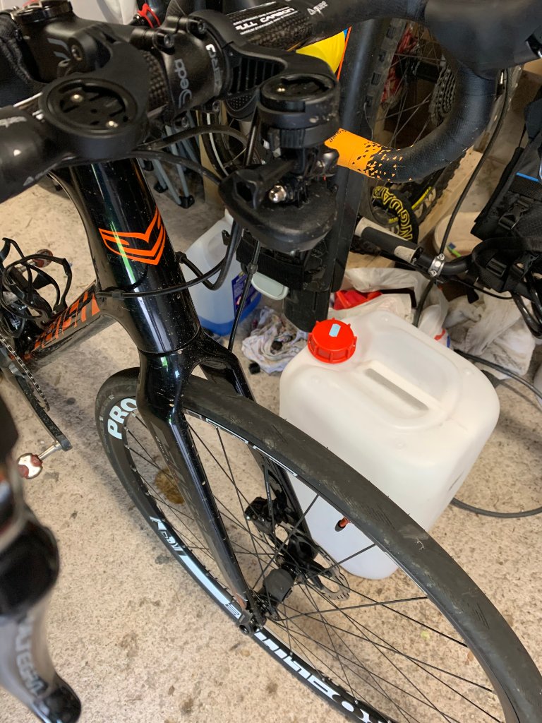

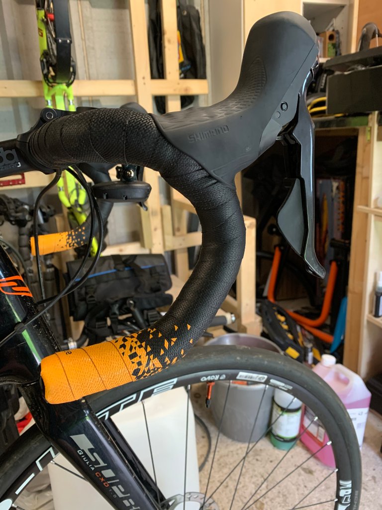

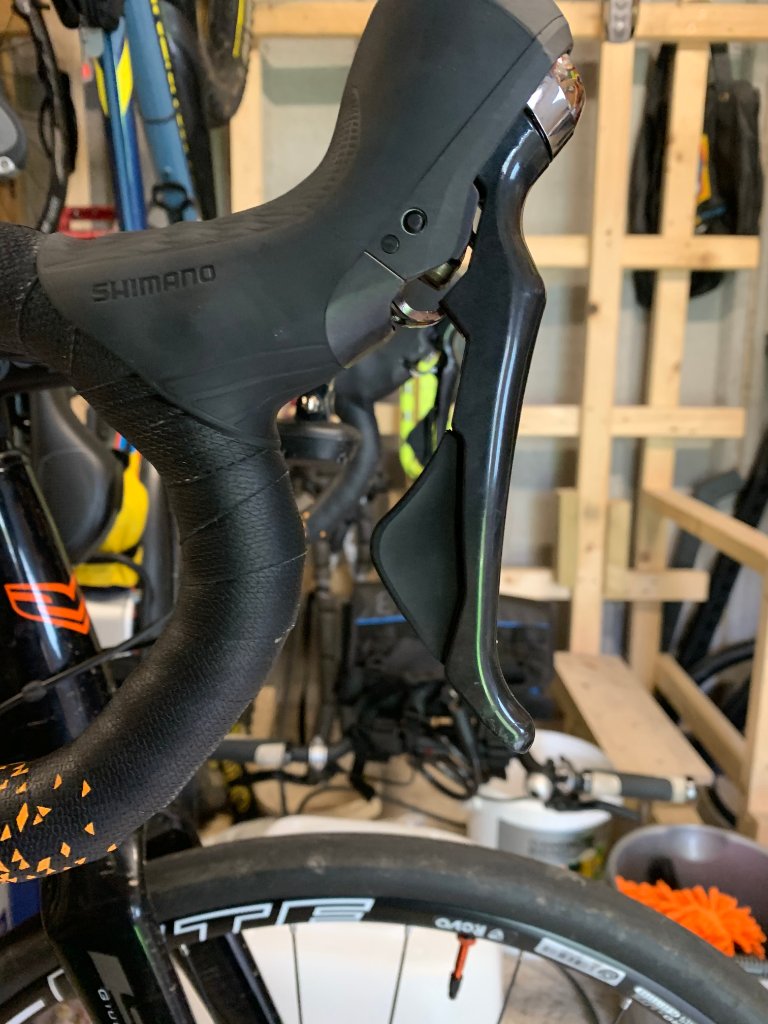

That just doesnt make sense so are my bars / pod position cuasing issues? I run it on a garmin outfront mount and from the side the pod is definitely sheltered by the bars and brakes so it'd be reading dirty wind.....see piccys. I have two bikes both with an outfront and a garmin varia mount to make switching bikes easy. I do have some gopro extensions so do I need to try and move it forward to clear the bars and get into open space or is it just a fact of life that it cant cope with stsrong cross winds?

What do you recon to a gopro extension to shift if forward a couple of cm’s......or about 1”!
