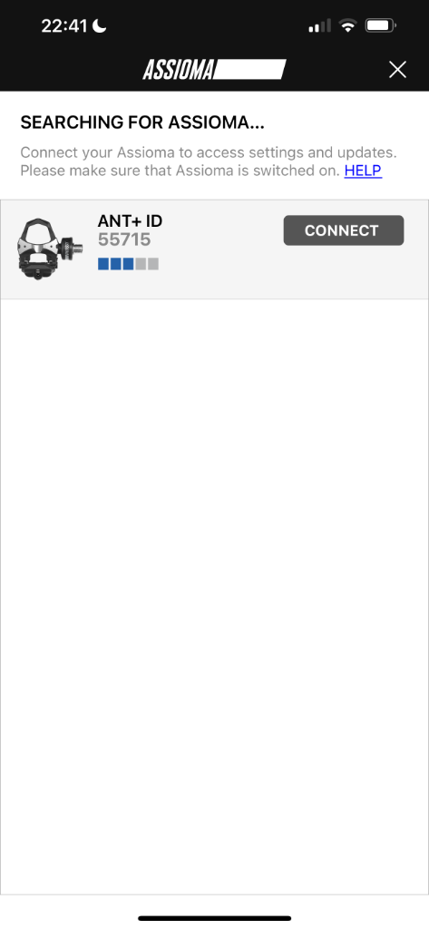

In terms of pairing the Assioma pedals, do I actually need to do this via the PowerPod and then do a out and back ride.
Before seeing your post I’d just downloaded the profile from the PowerPod and updated the DFPM 5 Chr ANT+ ID in the wireless id’s section and then re uploaded it to the PowerPod.
The Assioma ID looks to be 5 digit as per the attached.
Won’t that work?
I finally going to have a bit of time to do this DFPM calibration.
Won’t that work?

It is very likely that if you manually enter the DFPM ID into your profile, your PP won't "read" the DFPM data.nicholp1 wrote: ↑Thu Apr 06, 2023 4:36 pm Hi John
Won’t that work?
The sure way to handle things is to do a sensor pairing. Any time a sensor pairing is done, a cal ride is required.
