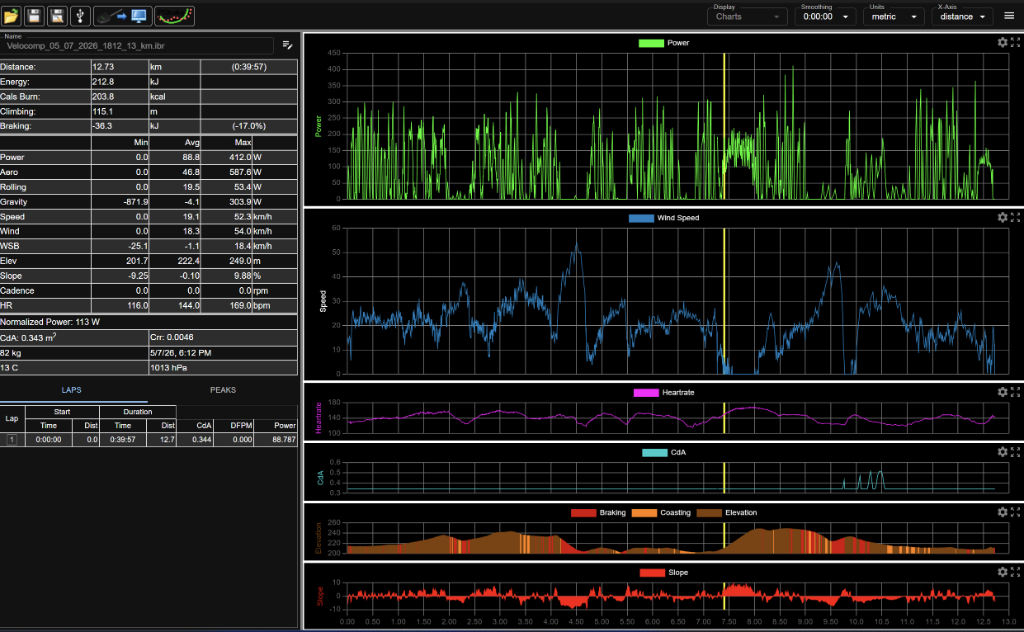

Today, I repeated the calibration process from scratch (still a bit windy but rather stable in terms of strength and direction) and set up the bike profile with the Velocomp Aero Software. The results of the ride immediately following the calibration have been much better:
- Much less and shorter "Zero-Reading" intervals
- Thus slightly less variation / more stable power readings
I have attached a screenshot of the ride as well as the original .ibr file.
Pls. note that there was a very consistent power reading in the second half of the ride (cursor position in the screenshot) with the "wind speed" indicator being stuck at Zero. I am not sure if this was due to riding uphill or simply because of the fact that "wind" was (possibly?) not part of the calculation? In any case, I did not drastically change my riding / kicking style in that section. There are hardly any "cruising" intervals when riding - I always do 10 kicks with one foot, then switching to the other (changing feet requires a small fraction of a second)
Generally I found that strong changes in the wind speed detection did have a very high impact on the power readings (much more than what I felt in "real life"). Do you think that there could be something wrong with wind speed detection?
Best regards and kind greetings!
Christian
Velocomp_05_07_2026_1812_13_km.ibr
(151.79 KiB) Downloaded 1 time
Screenshot 2026-05-07 203144.png (272.46 KiB) Viewed 16 times
