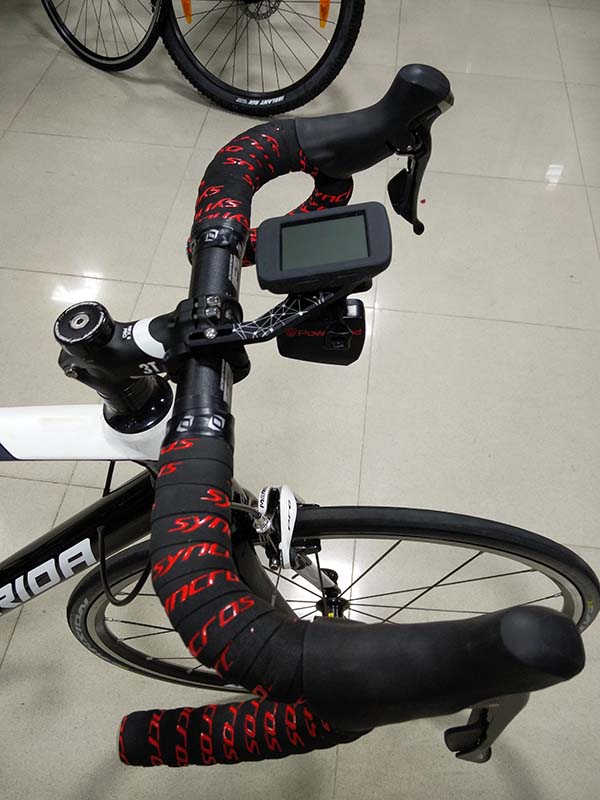

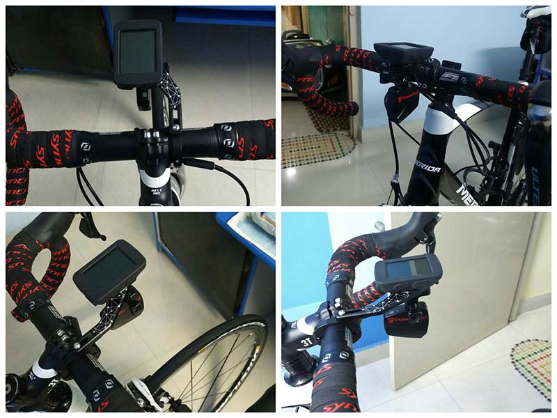

Hi, As said before my Alloy combi garmin/ gopro mount came. I have Removed all my aerobars and converted my crowded cockpit into a roomy one now finally.
Can you help me on how to go about it please?

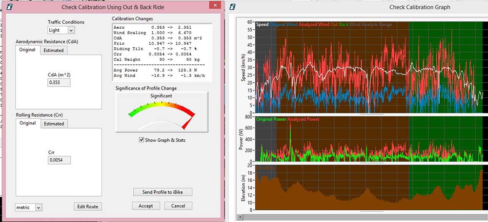

I did my first ride with front combi mount today. I setup my PP with a new profile (with all the parameters and front mount) and clicked on Best Accuracy and it asked me to do a Cal ride.
Here is the full ride file It was a solo ride Out and Back with no drafting only on hoods. First part of it around 1.65kms was the Calibration ride (where power rose from 0W to 100W) after which it started to show power. The ride after the calibration ride was out and back ride too for around 14kms with no drafting solo ride with riding on hoods. The power values were predominantly on lowerside when compared to my previous rides.
I tried to do a selection around the midpoint of my second ride and chose a symmetrical elevation around it and clicked on keep selection and did a Analyse calibration and it is showing a significant change.
This is the ride file of the selection i have done from original ride and it is showing this
Should i accept this change. The windscaling is 6.670. I read that the wind scaling should be around 1.7 for front combi mount in another thread in the forum? is something wrong?
please advise
please advise

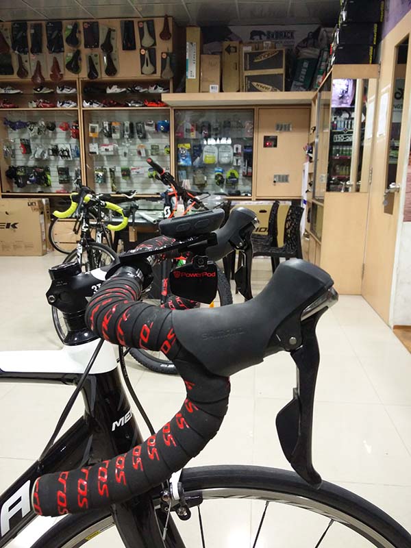

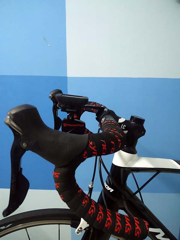

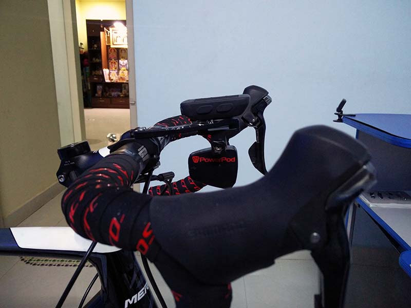

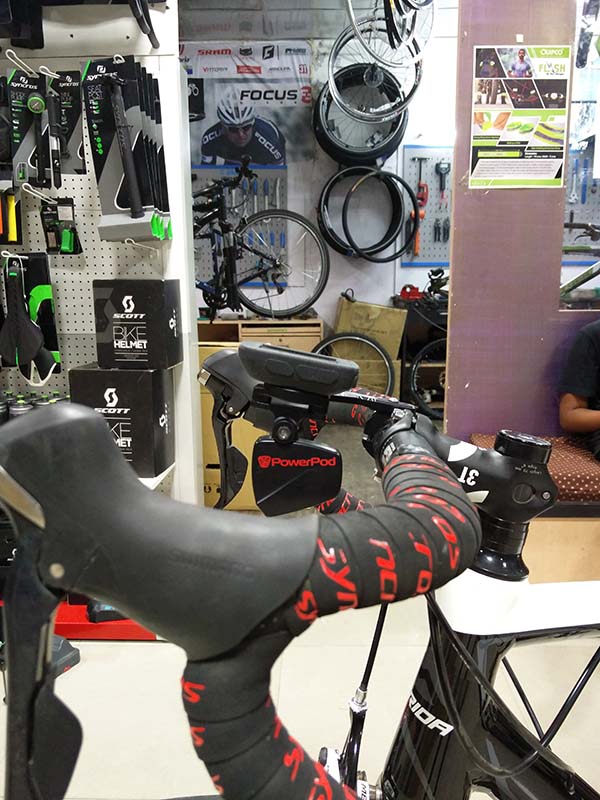

Re: Newbie to Power Can someone help me set up PP correctly

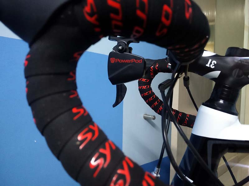

Hmm...please post photos showing how your PP is attached to your bike
Please contact technicalsupport.com for a warranty replacement. Your PP is not reading speed data properly.

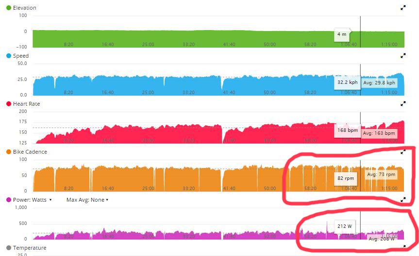

As advised by you , i did a ride today with the updated profile you had sent.
It was a 38km ride out and back to same place , solo (no drafting), on hoods. It is overestimating now, I rode predominantly in zone 4 but nowhere near a ITT effort and it gave me a new FTP of 230W in 20mins and avg power of 208 W for todays ride. i have not been riding for past 1 month and my previous FTP was 203W which was on a FTP test. No way my FTP could have incresed by this much. I am enclosing un altered the ride file for you to look at

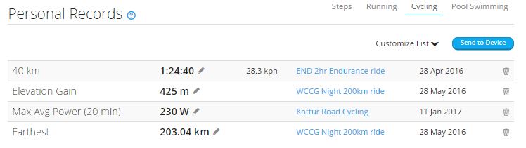

You can see this FTP record from my garmin screenshot below
Now there is another problem, Issac doesnt have any power and cadence data after 31kms in my ride file attached above, though i am 100% sure that i was able to see cadence and real time power in my garmin for my full ride and even the garmin has recorded the powerdata from PP for full ride
You can see the power data from PP and cadence from the sensor relayed to my garmin for the full ride from screenshot from my garmin connect. Any idea on why power and cadence data is not visible in the ibr?. is it because of lack of space in PP since i had not deleted previous Powerstroke incorporated Hidef files of greater than 6hrs from PP?
Do please let me know if u want me to do a ride again tomorrow and post a file here
Drashkum

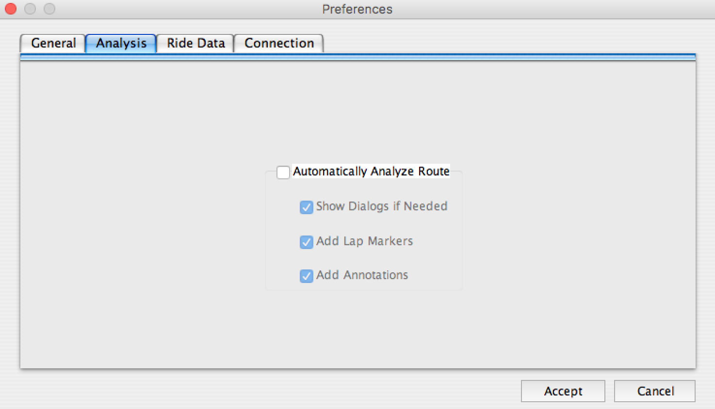

I don't understand why your cadence dropped out; that is a mystery.
Your ride file has been analyzed; it is not the "raw" data. In the Edit/Preferences menu, make sure the "Automatically Analyze Route" box is unchecked.
Please post the unanalyzed file.
- Screen Shot 2017-01-11 at 7.48.40 AM.png (68.71 KiB) Viewed 17234 times
