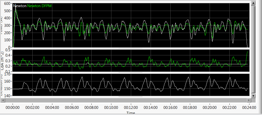

Dragged the TT bike out to a few races recently, then used it for a comparison with my DFPM. It's a single sided Favero Assioma, which has proven faultless so far on multiple bikes, and reproduced data calculated from bikecalculator.com with very good precision on road and TT bikes on closed circuits. Sorry to say, but it is even easier than the PP to swap between bikes (just need the Park HT8 Hex wrench).
Anyway, after resetting my arm position to horizontal, and rotating the PP forward (it's mounted on a dual Garmin mount on the extensions), I rode 33 laps of a closed 0.9 mile circuit with both PP and DFPM. No aero toys or wheels, save for a helmet, and the windiest of windy windy days - 25 mph!
Of course the original data said that I was 500W plus - hello Tony Martin! So after tweaking the net average wind speed to zero - it is a closed circular course, and a little extra tweaking of Crr (0.0035 for 25c Schwalbe Ones with latex inner tubes) and CdA (0.235 I'm pretty aero with a flat back), the results look rather promising. The CdA from Issac doesn't change in the plot because I did not get out of position at all - I've confirmed on another ride that it detects when I sit up on the base bar - but I do want to move to more accurate testing with changes in wheels, skinsuits, and of course position (slightly higher arms). I think 11 laps (which is the usual race distance) will be plenty for proper testing.

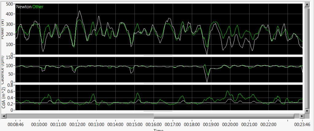

Another file for your records - again a windy day on the same circuit. This one was a 10.3 mile TT race (11 laps), so faster than calibration ride. Same Crr and CdA as before. But in this race I was going faster into the double bends which meant that I couldn't stay in position. Ignore the first few minutes, as PP was calibrating after I'd altered the front (again). Agreement is very good, but as I would expect, the PP has a wider distribution due to the very windy conditions that day.
I paced this series of races solely on PP last year. Readings were a little higher, but the use for pacing was absolutely rock solid.
I'll get some still data soon for the poster shot, and you are free to use them as you see fit!
EDIT - in fact it was the warm up - I'm a bit faster than that! Then stopped and forgot to start the PP again for the race immediately afterwards!

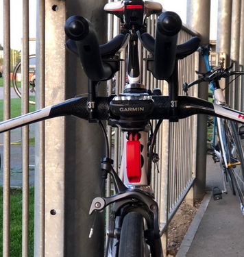

Another race tonight. Moved the PP onto a Garmin out-front mount to try and hide it. Raised the arm rests a bit to clean up the front end for more power (maybe).

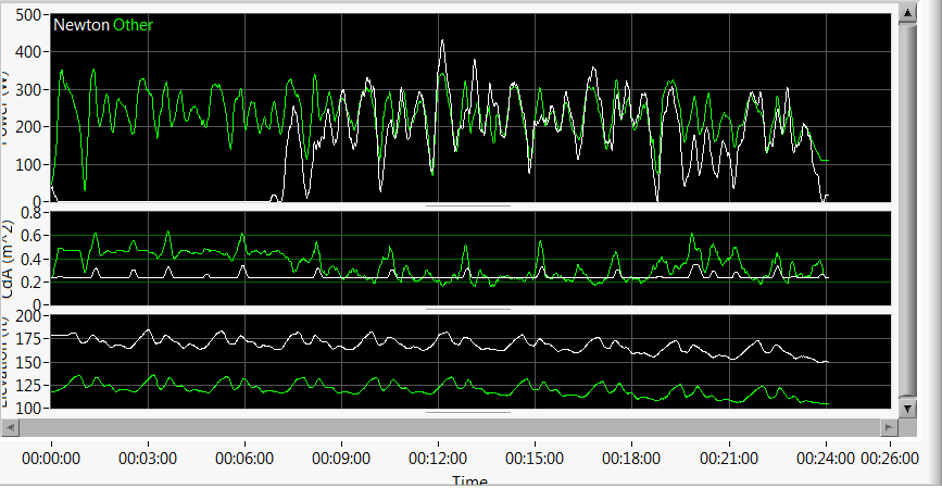

Calibration of 10 laps to set wind scaling (another windy day!). Then rode the race. Combined the data with my DFPM and here is the output. More details on this post http://www.timetriallingforum.co.uk/ind ... ce/&page=4
You'll see the nice clean mounting, the calibration ride, where PP needs to adjust to new position and tilt, and finally the race. Took a while to get an accurate merge of the DFPM and race data, but all good and very pleasing. Now to see whether I'm more aero and have better power!
- PP needs 8 minutes to self-calibrate
- PP_calibration.PNG (100.36 KiB) Viewed 5753 times

- Front end of the bike
- PP_mounting_new.PNG (396.33 KiB) Viewed 5753 times

Full calibration ride. NOTE power should be off for last bur one lap because I am sat up on the base bar (hence CdA is higher than model expects). My point is that after a little work, with wind calibration etc, you can get some very nice data indeed.
- PP_calibration.PNG (28.31 KiB) Viewed 5752 times
