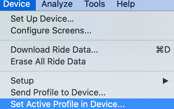

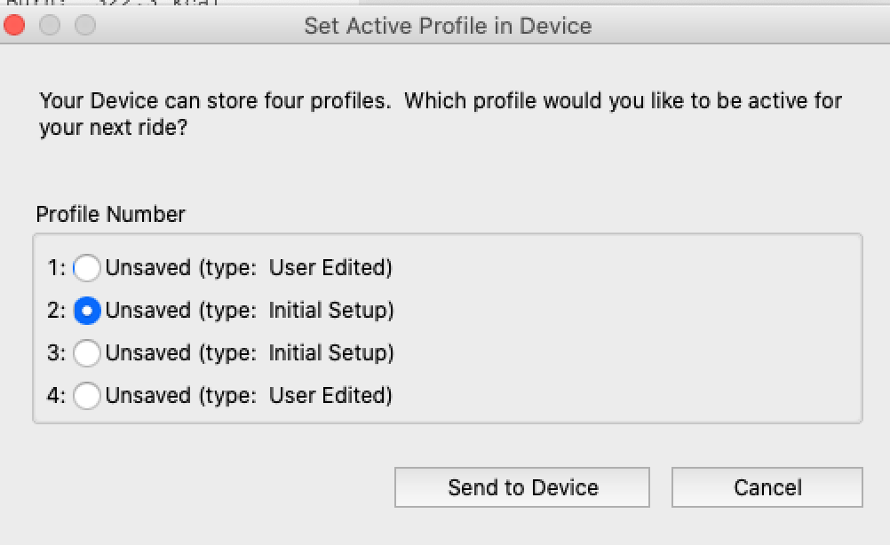

How are you changing profiles in Isaac? Are you using the "Device/Set Active Profile in Device" command, or something different?
You will see these screens:
Screen Shot 2020-06-24 at 2.53.09 PM.png (289.55 KiB) Viewed 4491 times
Screen Shot 2020-06-24 at 2.53.20 PM.png (47.97 KiB) Viewed 4491 times
Please do the following:
1) Connect PP to Isaac
2) Go to Edit/Edit Profiles/Extract from Device
3) Extract all of your profiles and post them here
I can't think of any reason you should have to do a cal ride anytime you switch profiles. And yes, it's fine to use the same speed sensor across multiple bikes, as long as you are willing to set profiles manually.
