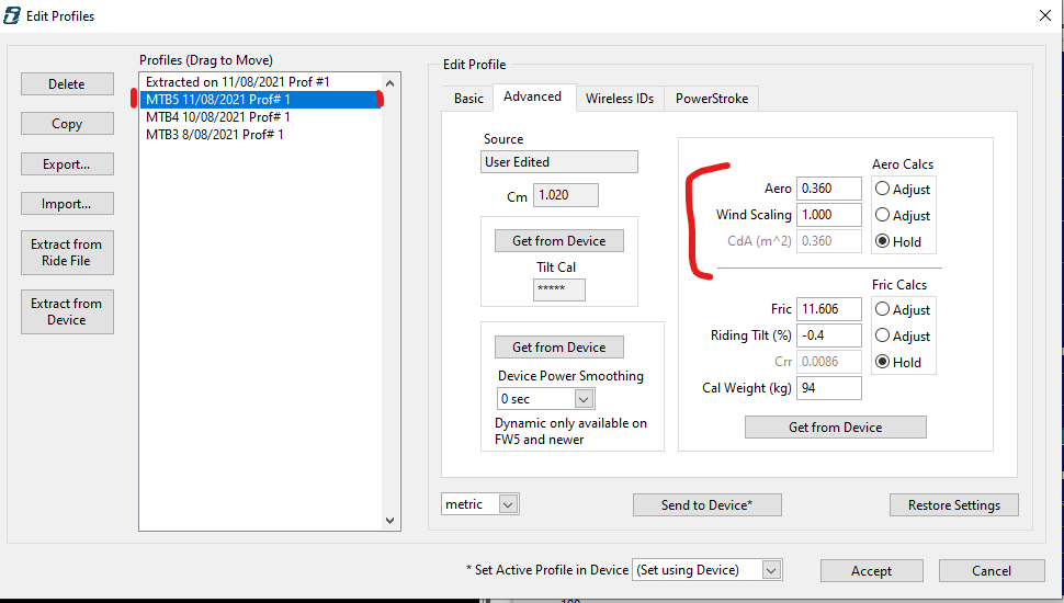

Loving my Powerpod and all the incredible data it is producing! - just a couple of questions on what to expect when calibrating.
I have performed 3-4 Cal rides now, just experimenting with adding correct weight/wheel circumference/CRR before hand... (also finding a relatively flat piece or road on a day that's not to windy)
1. Enter "Setup Device" Create new Profile and select "Best Accuracy"
2. Open New Profile and edit Wheel Circumference to "Measured" and add custom CRR based on my tire/pressure
3. Send to Device --> Accept
4. Follow Cal O&B Instruction's..
6. Continue on 20-30km ride...
Question 1.) When I return home and plug in the PP I download ride data but only ever see 1 x .ibr file. I have yet to see a CAL.ibr - when analysing the ride file it appears the Calibration ride is included in the subsequent 20-30km ride. Is this expected behaviour?
Question 2.) When I open my Profile if I select "Get from Device" I receive an "Extracted Profile" - this profile has the calibrated values - am I correct in saying this is the result of the Calibration Ride?
.ibr attached
Thomas_08_11_2021_1156_34_km.ibr
(256.79 KiB) Downloaded 256 times
Re: No CAL.ibr? Calibration Process/Questions
1). We no longer record calibration ride files.
2) Yes
