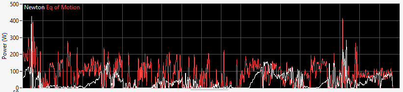

Lock up issues aside, the data makes no sense. I see that during the ride, but I though some configuration that I missed, however, although my CRR was too low for a MTB 2.3 tire, it doesn't explain the amount of error. I use the "Power meter compare tool" on Isaac (any plans to include it on Velocomp) and the power is correctly calculated if I use "speed/wind/elev", but using "speed/wind/slope" shows the same error as the PP during the ride. It looks like the slope is not correctly calculated, the graph looks ok though. The elevation is off, but that was around the same error I had with the PP3, -100m, but that doesn't explain the error on slope as the equation of motion calculates correctly my power.

I sent the info to technical support, but no answer yet. I really want this to start working again, at least like the PPv3 because the power is almost zero everytime that the slope is above 2 or 3%.

Everything is fixed now, thanks for all your support. The accuracy on the PP5 is really awesome, much better than the PP3.
