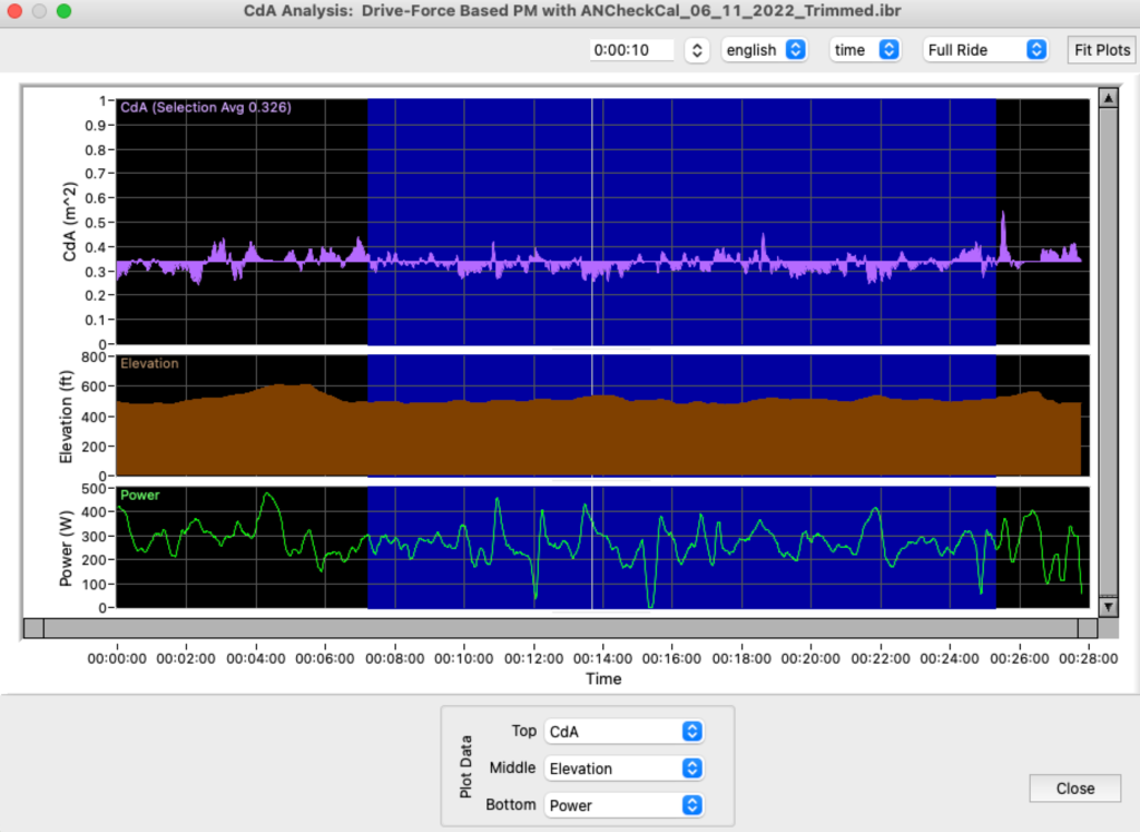

This is a really tricky thing you're trying to accomplish with this setup:
1) You have two different bikes with two different calibrations
2) You're trying to do comparisons in profile 3 (profile 4 is much better for precise testing)
3) Your Crr in both bikes was 0.006--high for road tires. The HR/CdA calculations are based on this value of Crr, irrespective of changes you made afterwards (to 0.004)
4) Your wind speed calibrations were slightly different for the two tests. Small differences in wind calibration can cause material differences in CdA
5) The result of the above is that the HR/CdA data isn't good for these tests
Here is what I did:
1) I used the command "Analyze/Return to original Download" to get both files back to the conditions actually recorded during your testing.
2) I used the command "Device/Check Calibration/Use DFPM" to correct the files for differences in wind calibration
3) I used the command "Tools/CdA Analysis" and highlighted the flat portion of the rides to get the CdA numbers for the corrected files.
With these changes I got the following:
6/3 ride, Crr .006, CdA = .307
6/11 ride, Crr .006, CdA = .326
So, it looks like your bike 1 setup is definitely more aero...interestingly, the difference is about 0.019, almost same as your analysis determined.
NOTE: The above analysis does not take advantage of most of the advancements in recent AeroPod firmware. It would be much better if you repeated your testing using profile 4, according the instructions for profile 4.
