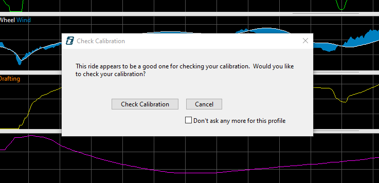

I performed today aero tests. Before them I did factory reset of my aeropod and performed new setup followed by calibration ride.
After tests, when I connected aeropod to Isaac and tried to download ride data, I saw Check Calibration dialog (attached): "This ride appears to be a good one for checking your calibration. Would you like to check your calibration?"
Is it worth to perform such calibration check in Isaac? Will it lead to better test results or the settings from calibration ride are already all I need and I should just cancel this calibration check in Isaac as it has no impact?
Regards,
Bartosz
Re: Check Calibration feature in Isaac, should I use it after calibration ride?
Isaac looks at each ride file and, when it thinks you are riding on a course where there is good out-and-back data, posts this message.
In profile 4 your AP is constantly doing calibration checks, and they are more accurate than in Isaac.
No, I would not do it.
