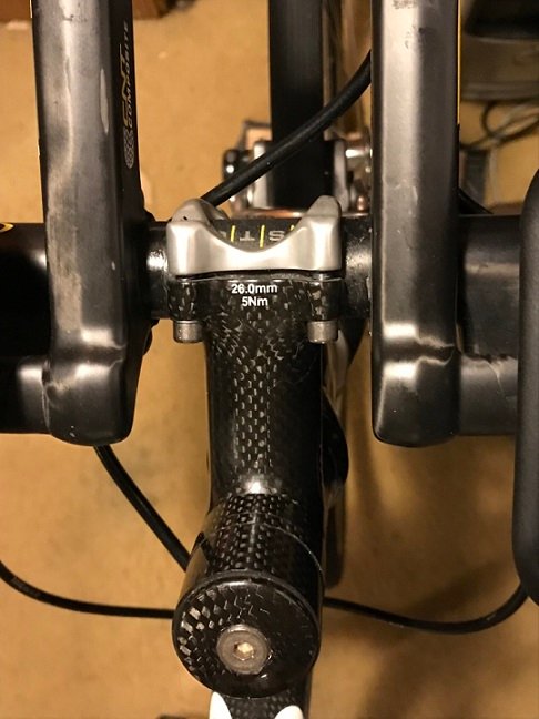

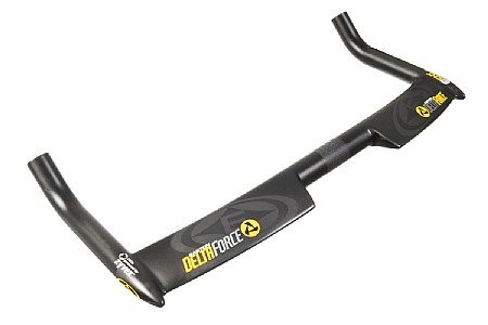

The first picture is a top view close-up of the stem and aerobar extensions. The second a stock photo of the bullhorn handlebar. I know this is old-school stuff. I am not the original owner of the bike, a 2009 Cervelo P3. I am not sure how wide the mount is that comes with the aeropod. Could it fit between the aero-bar extensions and the stem? The handlebars are Easton Deltaforce with Easton Aeroforce carbon extenstion bars.
Re: TT bike mounting
Here is the stock image I mentioned. I will post other pictures of the handlebar and extensions later. Could a mount like the Newton Dual be designed for the AeroPod? Even better, a mount that used the same idea as a hose clamp but the band would be flexible enough to mold around any shape.

How much room is there between the extensions and the stem?
Alternatively how much room is there on the round section of the base bar on the outside of the extension?
I don't have calipers to get an exact measurement but all of the mounts I checked are about 3/8" (~9.5 mm) wide.

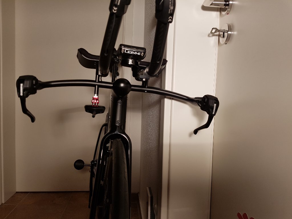

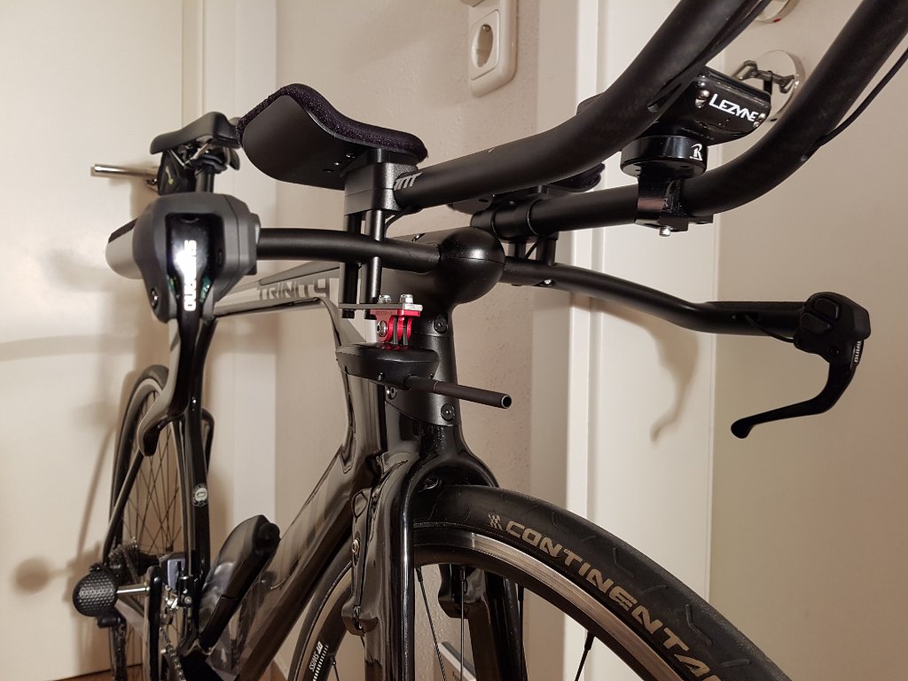

Hey,
after reading the revised instructions for firmware 7.06 I think I need to check my setup since my AP is attached to my aerobars. However, it is rather close to the massive alloy sleeves connecting the extensions to the also rather massive base bar. So I hope this setup is still fine.
The mount itself is aluminium and attached by epoxy resin and screws into the extension.

We strongly recommend against attaching AP to aerobar extensions, even when the underlying AP mount is stiff.
The reason is that most bars flex, which causes problems with AP slope readings.

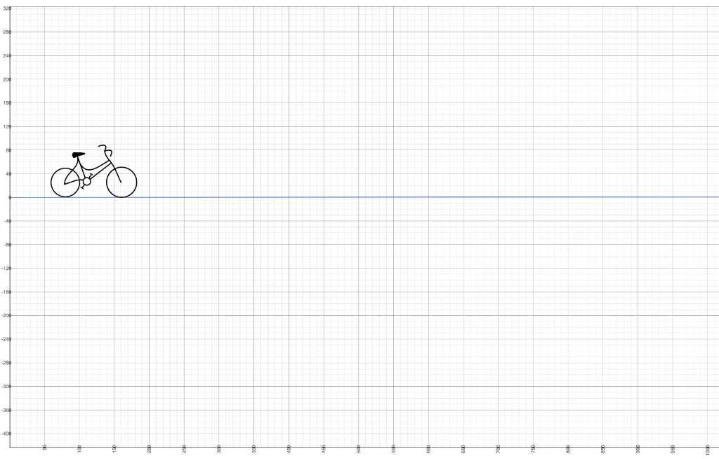

Slope is a very important measurement in getting best-quality CdA readings. AP can resolve slope differences as little as 0.05%. To give you an idea of just how "sensitive" this is, here is a bike riding on a "road" with 0.0% slope--completely flat. After riding 1000 feet (right side of plot) the the elevation has changed by 0 feet:
Now, here is the same plot, this time with a 0.1% slope--twice the difference that AP can detect. After traveling 1000 feet the elevation "climbed" is just one foot!
No cyclist can physically detect a 0.1% slope difference, but AP can. AP's sensitivity is why you can't have any flex in the AP mount.
Your bars look pretty stiff, but this is just an impression...
Do a short ride, where you ride on a straight road for the first 5 minutes. While riding try to flex your bars during the first 5 minutes of the ride, as you might do when moving from hoods to TT position, or pulling on the bars in a sprint.
Post the ride file and I'll take a look...

Based on your HR/CdA channel readings your CdA for that interval is about (58.5+180) / 1000 = .2385 That is a very reasonable value.
I've adjusted your profile to use the lower CdA value measured. Load this into your AP.
You've got a really impressive 15 minute interval in your ride!

I have two additional questions.
1) First is about the difference in calculations. If I separate my TT effort (attached to this post), it gives me average HR of 58.6, what corresponds to calculation given by you for my CdA ((58.6+180) / 1000 = .2386). Actually, I used Profile 3 for this effort, so maybe I should use the second formula: 58.6x4 / 1000 = .2344. Nevertheless, if I go to to Tools->CdA Analysis, I get CdA of .246 instead. What do you think - from where comes this difference and what is more reliable calculation for this effort?
2) Second is about AP mounting. If I experiment with stack high of my pads, AP goes up or down or little more forward to its initial position used in calibration ride, is it better to repeat calibration ride? And can you give me some details on how you calculated changes to my profile, just for better understanding?
Regards,
Bartosz
