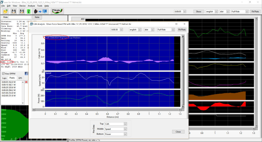

I am puzzled by a discrepancy between two numbers displayed by Isaac.
In both of the screen shots the entire out-and-back was selected in the CdA analysis display. In one case the CdA analysis result is almost identical to the CdA listed in the ride summary on the left but in the other analysis there is a large difference between the two. The relevant values are circled in the screen shots.
Two Different CdA values B.png (170.04 KiB) Viewed 3282 times
The attachment Two Different CdA values B.png is no longer available
This makes me wonder: What is the CdA in the ride summary supposed to represent? I'm assuming that the CdA analysis is based on whatever is selected in the CdA Analysis display and I would have guessed that the CddA in the ride summary was based on the entire ride ... but in that case if the entire ride is selected in the CdA analysis box shouldn't the two numbers agree?

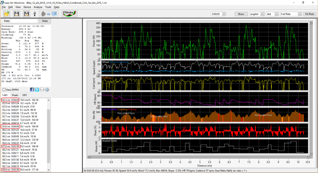

I will attach the IBR and a screenshot showing the relevant laps in the file.
If the GPS data are really necessary can I PM them to you rather than posting?
The actual analysis was done on the the 4 separate files represented by the marked laps.

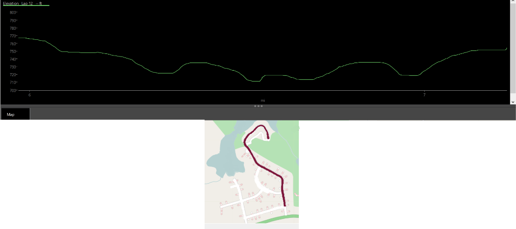

This shows the relevant portion of the GPS track and the elevation profile from the Garmin for the out and back section
