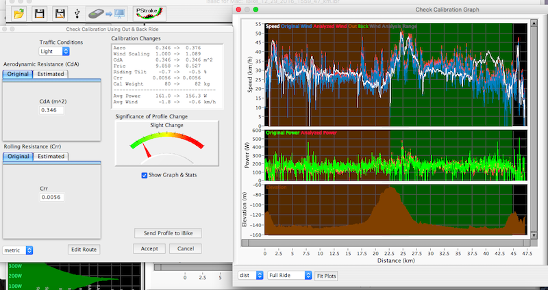

Re: calibration help please
Good day John,Velocomp wrote:Either alternative will work.
Today I made an out and back ride of 45km. (I attach the .ibr file)
Could you please say me if you see something wrong? Because there're a short time that PP read drafting, but I've ride alone all the ride.
Is this file good to made a check calibration? I attach a screenshot of what happen if I use Check calibration. Would be better to do other O&B ride shorter to check calibration?
Regards!

Thanks!!Velocomp wrote:This looks great!
Then... Would do you do a check calibration with this ride and send the new profile to PP with the changes like the pics? Or the profile is fine?
I think the PP is working properly, but I haven't made a "check calibration" before, and I use to read this like one of the step to tune in the profile
Regards!

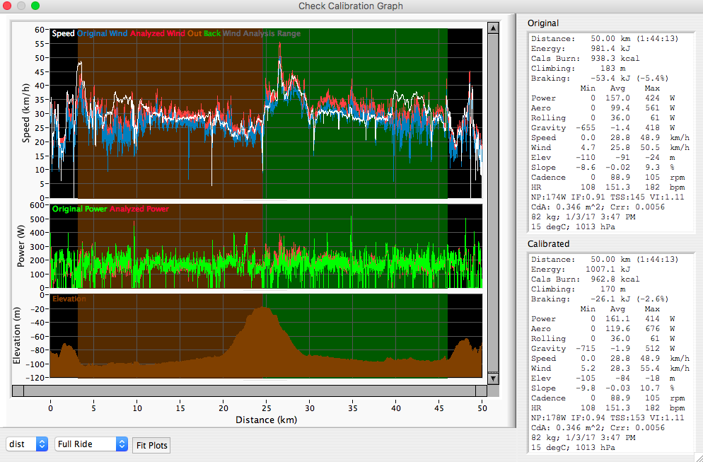

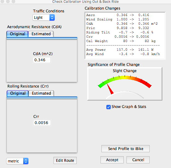

Hi again!! Here you are a new ride file.Velocomp wrote:I think you are OK, but do a new ride and then post it. I will check it.
Could you please check the calibration? I have take a screenshot of "check calibration tool", What do you think about it?
Thanks again, Best regards!!
This is a 50KM ride out and back ride., 50Km is quite long for the check calibration feature.
I note that, between KM 7 and KM 24.5, wind speed is almost identical to bike speed. This suggests your PP is well-calibrated.
Between KM 4 and KM 7, and KM 24.5 and KM 27.2, wind speed is less, as if you were drafting. However, this is in the same spot in your ride, suggesting that something else is going on.
I would leave calibration as it is.
Yes John, I have checked this spot and it's a section of highway. Some days like today there're tail wind in both direction, I don't Know how!!. I will keep the calibration, and I'll try to do a shorter O&B ride to can check properly to finish the tuning of my PPVelocomp wrote:This is a 50KM ride out and back ride., 50Km is quite long for the check calibration feature.
Thanks for all,
Best regards!!

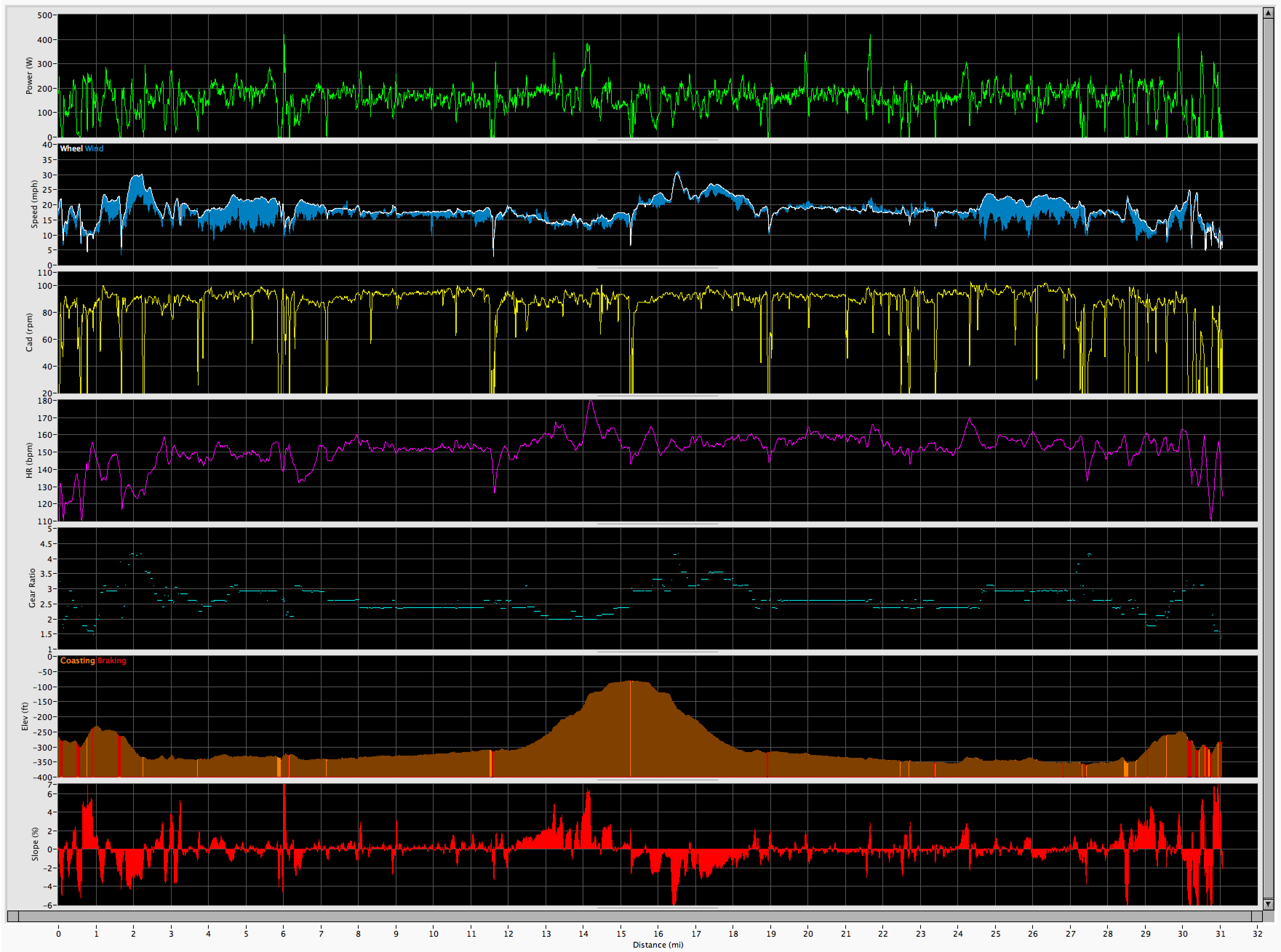

Good Day John,
Today I made a short training, 31km (19,26m). Here you have .ibr file to check calibration... if all is working properly, or I need to change something of the profile
Thanks in advance!
Thanks in advance!
- 10012017.ibr
- (226.12 KiB) Downloaded 554 times
This looks GREAT!!!Sergioperi wrote:Good Day John,
Thanks in advance!

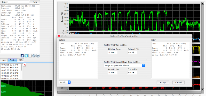

Hi john,
I was looking to set up my weight... because I gain weight in christmas, but something strange happen. I procced as follow:
1. I extracted the profile of my last ride file.
2. I edited my weight in "advance"
3. I change switch profile after ride.
Then, the average watts of the training decreased from 147.3 to 142.9... The watt should increase if I have gain weight no?
I attach a photo. Please, let me know if I'm doing something wrong.
Thanks a lot.
Thanks a lot.
- Captura de pantalla 2017-01-12 a las 19.09.53.png (258.54 KiB) Viewed 20843 times
This is something I have noticed happening too. I'm new to the Powerpod so still trying to figure everything out.
Here you have john!Velocomp wrote:Please post ride file.
thanks in advance
- 110117.ibr
- (342.98 KiB) Downloaded 480 times
